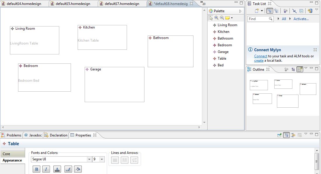

one of the uncorrect imports was "homedesign.homedesign.util.HomedesignAdapterFactory;" while it should be "import homedesign.util.HomedesignAdapterFactory;"
I solved these imports but the problem is when i embed diagrams by means of making relationships (e.g Kitchen should contain a Table inside it) i couldn't see the embedded graph...but i think it's added but not visible).
I attached a snapshot of the result, please check it out.
thanks for your quick response!

Re: Generating Editor Code [message #769743 is a reply to message #769710] Thu, 22 December 2011 11:07 Go to previous messageGo to next message
This is probably a bug in the generator that does not take into account
changed package names.
Please check wether it is reported or fix. If you find it as Open in the
tracker, please add a comment and your use-case (the former zip would
help). If you find it mark as resolved, then ensure you use the latest
version (2.4) of GMF-Tooling. Finally, if you don't find anything
relevant, please open a bug with the precise steps and resources to
reproduce your bug.
https://bugs.eclipse.org/bugs/enter_bug.cgi?product=GMF-Tooling
http://mickaelistria.wordpress.com
http://twitter.com/#!/mickaelistria
http://www.petalslink.com
Re: Generating Editor Code [message #769765 is a reply to message #769743] Thu, 22 December 2011 11:40 Go to previous messageGo to next message
