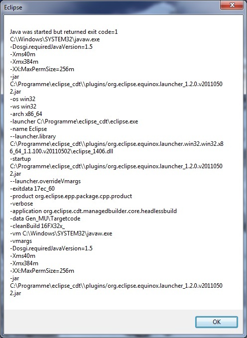

The project can be built in eclipse. But using the healessbuild a window pops up telling me that "Java was started but returned exit code=1" (see attached printscreen).
I think we have got a problem with Java 32 vs. 64 bit. I've already tried to
- set the -vm path in eclipse.ini to several different java installations
- set the -vm path as argument to the above command line
- set the environment variable JAVA_HOME
- set -XX:-UseCompressedOops in eclipse.ini (no idea what it does but read in a forum)
everything without any success.
What is wrong with my setup?
