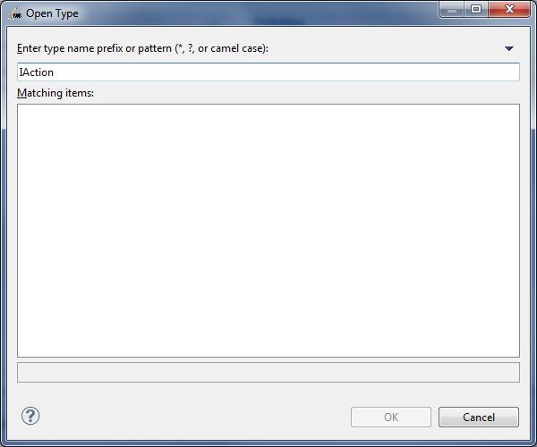

I tried to do as you said and this is as far as I got.
index.php/fa/3394/0/
There must be something from my Eclipse configuration that is missing.
Re: Find commands that are not in the Command Composer [message #698578 is a reply to message #698455] Tue, 19 July 2011 14:19 Go to previous messageGo to next message
Sometimes the JDK does not find classes that are not referenced from any project in your workspace. Try creating a plug-in project using the Hello World template and then see if you can open the type IAction. This should work because IAction is used in the run method of the SampleAction class in this template.
Re: Find commands that are not in the Command Composer [message #699605 is a reply to message #698578] Thu, 21 July 2011 18:06 Go to previous message
I tried what you said and it did not work...The Open Type dialog is still not populated.
