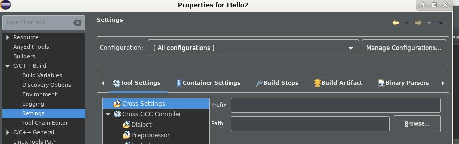

Re: Adding new "toolchain" to Eclipse. [message #1799174 is a reply to message #1799172] Fri, 30 November 2018 21:17 Go to previous messageGo to next message
When you select the Cross GCC toolchain,
a new entry appears in the Tool Settings tab dialog called Cross Settings
Project --> Properties --> C/C++ Build --> Settings --> Tool Settings tab --> Cross Settings
index.php/fa/34437/0/
Set the prefix in the prefix box: in your case arm-linux-gnueabihf-
Note the trailing '-'
Set the bin directory (Path box) with the Browse ... button.
Avoid using a relative path.
Set the compiler commands to the rest of the compiler names (e.g., gcc for C, g++ for C++)
I'm assuming those names and they look like the ones you have.
When a compiler is needed it will execute as <bin dir>/<prefix><command>
In your case, for C++, <bin dir>/arm-linux-gnueabihf-g++
You probably should select [ All Configurations ] in the Settings dialog.

Re: Adding new "toolchain" to Eclipse. [message #1799180 is a reply to message #1799178] Sat, 01 December 2018 01:47 Go to previous messageGo to next message
Then you are asking a confusing question.
It isn't clear if you already have the cross compiler you want to use or if you are trying to compile one.
All I can do is tell you how to get to an existing one using Eclipse CDT.
Which I've done.
If the compiler is found at tools/arm-bcm2708/gcc-linaro-arm-linux-gnueabihf-raspbian-x64/bin/arm-linux-gnueabihf-g++
You set prefix to: arm-linux-gnueabihf-
and Path to: tools/arm-bcm2708/gcc-linaro-arm-linux-gnueabihf-raspbian-x64/bin/
But the path should be an absolute path.

Re: Adding new "toolchain" to Eclipse. [message #1799202 is a reply to message #1799180] Sat, 01 December 2018 12:10 Go to previous messageGo to next message
You most likely do not need to add a new tool chain to your Eclipse in order to build your program. You should be able to configure the Cross GCC tool chain to get what you want.
Cross compiling can be quite confusing so you need to make sure you have a clear understanding of the concept and terms particularly the difference between host and target. Here is a link that may help explain the concepts https://wiki.osdev.org/GCC_Cross-Compiler.
This explanation assumes that you are running Eclipse on a Windows/Linux/Mac PC and are attempting to compile for a target Rasberry Pi device. This is not a procedure for running a compiler on the target Rasberry Pi device. This is an important distinction. This host where the tools are running is different from the target where the resulting program will run.
If you intention is to run the build tools on the Rasberry Pi device that will also be running the resulting program, you don't need a cross compiler.
Make sure you have the Cross GCC tool chain installed in Eclipse. (Help->About Eclipse IDE, click Installation Details and look for C/C++ GCC Cross Compiler Support).
If it isn't installed, use the Help->Install New Software dialog to install it. Be sure to restart Eclipse after installing.
Configuring the tool
Open Project Properties and go to the Tool Chain Editor under the C/C++ Build section. Select Cross GCC in the Current Toolchain selection box.
Select the Settings section right above Tool Chain Editor under C/C++ Build.
On the Tool Settings tab, select the Cross Settings item at the very top. This displays two text fields Prefix and Path. These two fields are used to narrow down the numerous cross compiler tools to the specific set you are interested in. Building a program involves a number of tools. You need to use a combination of assemblers, compilers, archivers, and linkers to get the program. If you look closely at the various directories you pullled down from the rasberripi/tools github site, you will see that there are several files that all end in '*gcc', or '*g++', or *ar', etc. These are command suffixes that denote the various tools used. gcc will compiler C files, g++ will compile C++ files, etc. Also notice that there is a common prefix that begins the name of each tool such as 'bcm2708-*', or 'arm-bcm2708-linux-gnueabi-*'. This prefix specifies the target architecture that the tool is built for. Combining the prefix with the various command suffixes gives you the set of tools required for the target platform. This prefix string is what you place in the Prefix field of the Cross Settings.
The Path box should contain the absolute path to the folder where the tool chain files reside. If you have cloned the git repository into a directory called /tools and you want to use the tools in the arm-bcm2708/gcc-linaro-arm-linux-gnueabihf-raspbian-x64/bin/ folder, you would set the Path text field to 'tools/arm-bcm2708/gcc-linaro-arm-linux-gnueabihf-raspbian-x64/bin/' This gives Eclipse the place to start looking for the tools. If you want to use the arm-linux-gnueabihf tools, you need to set the Prefix to 'arm-linux-gnueabihf-'.
Eclipse will now combine the combination of the Path and Prefix strings when picking the individual tools. For instance, the default command for the Cross GCC Compiler is gcc (This is the C compiler). Eclipse combines these three strings together to come up with a command 'tools/arm-bcm2708/gcc-linaro-arm-linux-gnueabihf-raspbian-x64/bin/arm-linux-gnueabihf-gcc'. This will then be the command that is run when compiling C source files.
