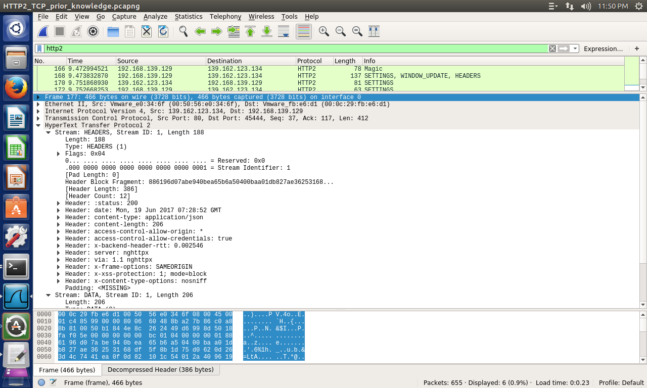

Support for HTTP in Titan comes in several, somewhat confusing forms:
The HTTP test port ( or rather the associated small protocol module):
https://github.com/eclipse/titan.TestPorts.HTTPmsg
supports HTTP 1.0/HTTP 1.1
The below confusingly named HTTP protocol module
https://github.com/eclipse/titan.ProtocolModules.HTTP2.0
again supports HTTP 1.0/HTTP 1.1 , but with more user-friendly structures, and it is considered version 2 relative to the one in the test port.
Finally git://git.eclipse.org/gitroot/titan/titan.ProtocolModules.HTTP2.git HTTP/2
is a genuine HTTP/2 implementation.
As in some of the scenarios the communication starts with HTTP 1.1 messages , I have used both the above protocol modules.
As transport I have again used the IPL4 of which you are probably bored to death already.
Here's the code deployed:

Note3: If one checks the decoded headers might notice that they are wrongly decoded:
23:41:55.096525 HTTP2.ttcn:357 **********received header frame
23:41:55.097873 HTTP2.ttcn:362 ************received header block:  { pseudo_headers := { method := omit, scheme := omit, authority := omit, path := omit, status := 200 }, headers := { { header_name := "date", header_value := "Tue, 20 Jun 2017 06:41:56 GMT" }, { header_name := "content-type", header_value := "application/json" } } }
while Wireshark shows:
index.php/fa/30863/0/
In fact the decoder works correctly , but the headers contain extensions that are not (yet) covered.
