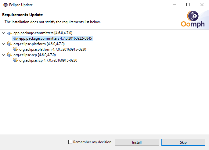

Hi guys,
> Monday
Oomph presents me with this dialog. What does it mean?
https://www.eclipse.org/forums/index.php?t=getfile&id=27482&
> Tuesday
I pressed the install button and now I know.
I upgraded to Oxygen by adding the repos and "check for updates". After restart, I see this popup. Not knowing what it was but trusting in the might of Oomph I pressed the install button. After restart I was downgraded to Neon.1 again.
Before I pressed the button I thought it could mean two things:
1. Oomph is confused and wants me to downgrade.
2. Oomph sees some missing bits after upgrade to O2 and wants to fix it.
I hoped for 2 but I got 1. Can you tell me a little bit about what is going on?
Cheers,
Wim

Comments below.
Wim Jongman wrote on Fri, 04 November 2016 04:28
Hi guys,
> Monday
This dialog is new to 1.6. Before this dialog was added, Oomph would have simply performed the p2 task and made this change. The shows what will be installed and what is currently actually installed.
> Tuesday
Indeed. No doubt you created the installation choosing Neon as the product version and that product version constrains the root unit versions to ensure you don't accidentally upgrade to something other than Neon. If you'd picked Latest it would have updated to Oxygen as soon as an Oxygen build was available.
The dialog was added so that users are aware that their installation will be changed and to give users full control over whether the installation will be changed.
Cheers,
Wim
Re: What does the "Requirements Update" dialog do? [message #1746879 is a reply to message #1746768] Mon, 07 November 2016 03:34 Go to previous messageGo to next message
I see. Thanks. Obviously, the dialog was not clear to me and there is no help yet (I was looking for the spinning question mark Wink.
Yes. It would be nice if that (my setup requirements) could be corrected. Do I have to run Oomph stand alone again? Now I get the update dialog on every restart. I can switch it off, but do I want to do that? Do I miss other updates if I do?
Wim
Re: What does the "Requirements Update" dialog do? [message #1746881 is a reply to message #1746879] Mon, 07 November 2016 03:53 Go to previous messageGo to next message
Yes, help would be good.
You can open the Installation setup (Navigate -> Open Setup -> Installation) and in the properties view change the product version to say Oxygen or Latest and then Perform Setup tasks will update the installation. Depending on whether you have other things than the product version contributing to what the p2 task does you would miss updates to those contributions. But of course any time you manually perform the p2 task, it will change the installation to be Neon again...

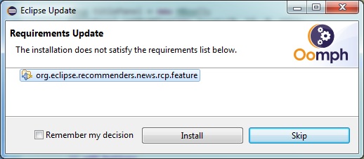

Re: What does the "Requirements Update" dialog do? [message #1778754 is a reply to message #1746752] Wed, 20 December 2017 16:33 Go to previous messageGo to next message
I recently installed Eclipse to work on a Java program. I am now getting an Eclipse Update window when I open Eclipse. The information in the window is not descriptive at all of what the problem is or what the two buttons: Install and Skip will do.
index.php/fa/31647/0/
I have a pretty basic Eclispse install. Why am I getting this window?
The message says "The installation does not satisfy the requirements list below." The list has org.eclipse.recommenders.news.rcp.feature. What does this mean? Please decrypt this message.
The install button makes no sense since the message is that the installation does not satisfy the requirements. What will be installed? And why doesn't it list what will be installed?
What are the impacts if I use the skip button? And what if I select "Remember my decision".
Hopefully, someone can answer my questions and better yet improve the window so that it makes sense.
Re: What does the "Requirements Update" dialog do? [message #1778881 is a reply to message #1778754] Fri, 22 December 2017 15:43 Go to previous message
This suggests your installation doesn't contain a feature that's expected to be in your installation. This particular feature looks like a new feature that provide a news feed. You can install it, or not install it, and you can decide if you want that choice to be made automatically the next time this situation arises. I.e., you can auto update to install new things when there are new features to install or you can choose never to do that automatically nor to be asked.
