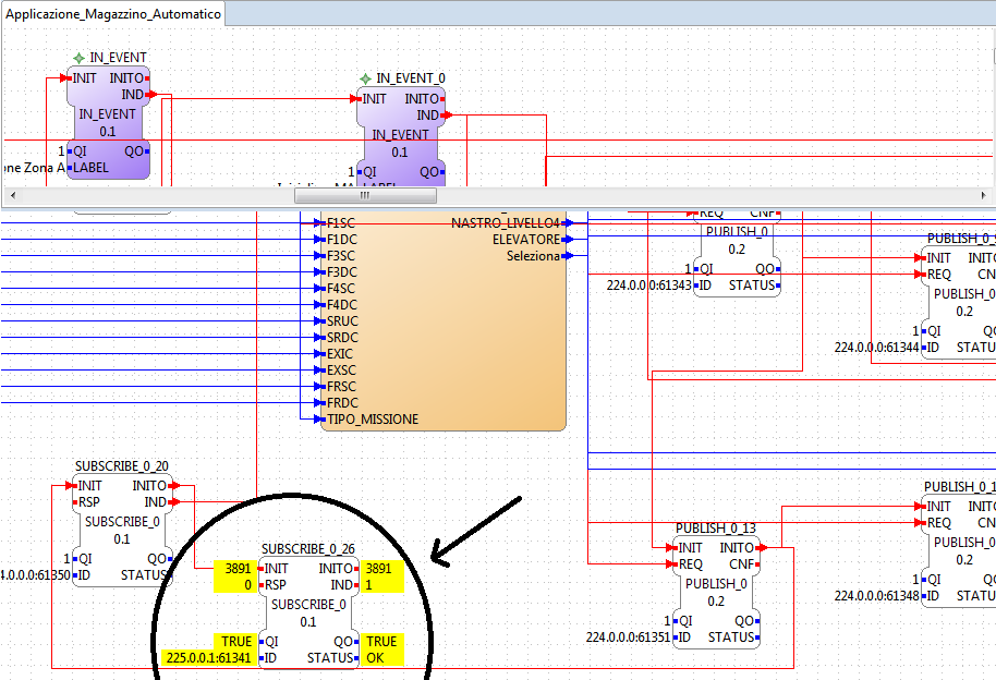

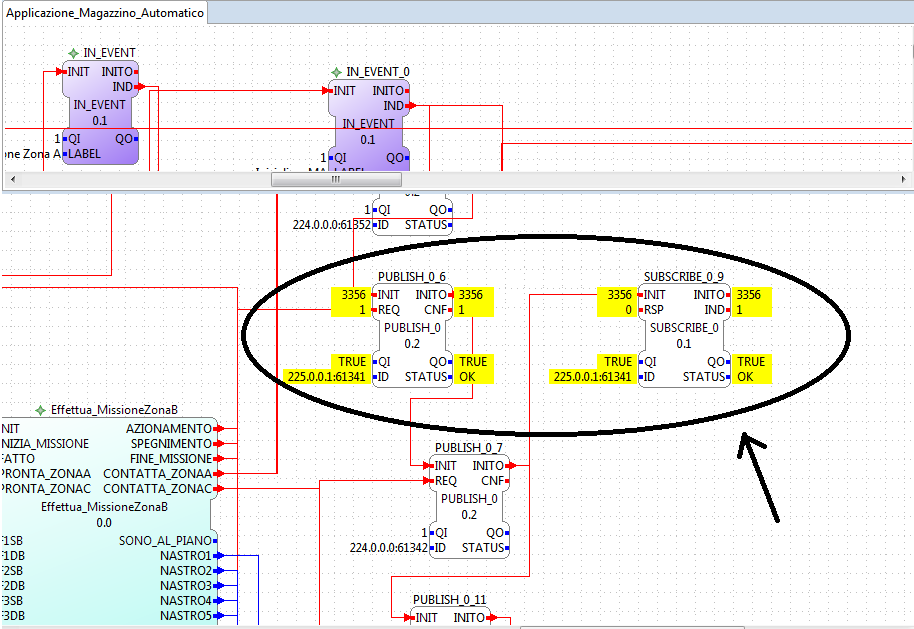

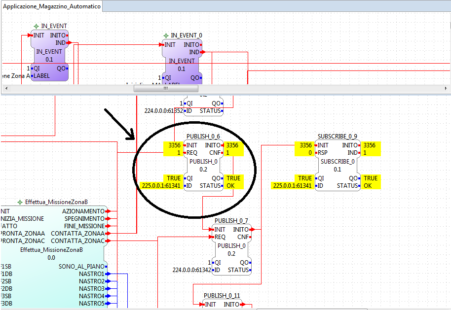

I want report an error in the communication Publish/Subscribe in my distribuited application (on 3 device).
I explain the problem better.
1. I have to publish the event CONTATTA_ZONAA on 225.0.0.1:61341 (in the attachement ZonaB).
2. This event, published, isn't received from PRONTA_ZONAB in 225.0.0.1:61341 (in the attachement ZonaA). But socket status is ok.
So, I tried to change ip and port also but nothing good result.
3. So, I tried to receive this event on another device (in the attachement ZonaC_trial) on 225.0.0.1:61341 always, and it's ok there.
Another trial:
4. I tried to receive this event on the same device of Publish (in the attachement ZonaB_trial) on 225.0.0.1:61341, and it's ok there.
Thus, in my opinion, the problem is on the device ZonaA.
What could be the problem?
Thank you.

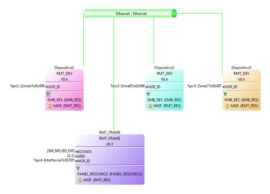

What does your network topology looks like? Is there a router in between Device A and the other devices, or are all connected on the same switch?
Re: Problem in communication Publish/Subscribe [message #1741869 is a reply to message #1741865] Tue, 30 August 2016 05:53 Go to previous messageGo to next message
Hi Martin,
my network topology is composed by an only router, and every device connected on the same.
I precise that in my application I have other communications of this kind (i.e between 3 device) and I have no problem.
In the attachement I show my architecture 4DIAC-IDE.
BR,
Michele Citro

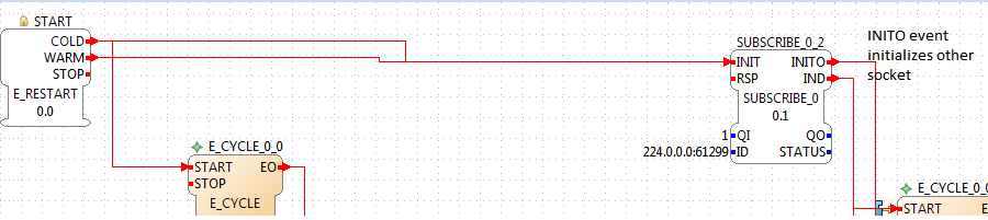

Re: Problem in communication Publish/Subscribe [message #1741900 is a reply to message #1741881] Tue, 30 August 2016 10:04 Go to previous messageGo to next message
you are right. It was a mistake, because I linked some Publish/subscribe's inizialization with a wrong event.
Now, after correction, Publish/SUbscribe FB are inizialized one time.
But the problem on this socket remains.
I'm sure that Subscribe FB's initialization isn't before the Event published,
because I link the first socket (on every device) with E_RESTART FB and this first socket initializes all other.
I show this in the attachement.
Best regard,
Michele Citro

Re: Problem in communication Publish/Subscribe [message #1741948 is a reply to message #1741864] Tue, 30 August 2016 13:54 Go to previous messageGo to next message
I'm not sure whether I correctly understand the following sentence:
"I'm sure that Subscribe FB's initialization isn't before the Event published,
because I link the first socket (on every device) with E_RESTART FB and this first socket initializes all other."
Does this mean that you are starting the device (and deploying the FB Network) with the Subscribe FB before you start (and deploy the FB Network) of the publishing device and publishing the event?
Have you tried to use the "Trigger Event" functionality to send the event a second time after all publish/subscribe FBs are initialized?
Gerhard
Re: Problem in communication Publish/Subscribe [message #1742788 is a reply to message #1741948] Wed, 07 September 2016 11:05 Go to previous message
If possible, try to look the run time log or trace. There may be possibility of dropping the events since Forte is only capable of storing 254 events in it queue.
Or else there may be a chance of Publish happening before the Subscribe function block getting initialized.
Other option that you could try out is complete all subscribe initialization after E_RESTART and then start you application by connection the last Subscribe function block INITO.
As suggested by Gerhard, you can try with "Trigger Event" also
