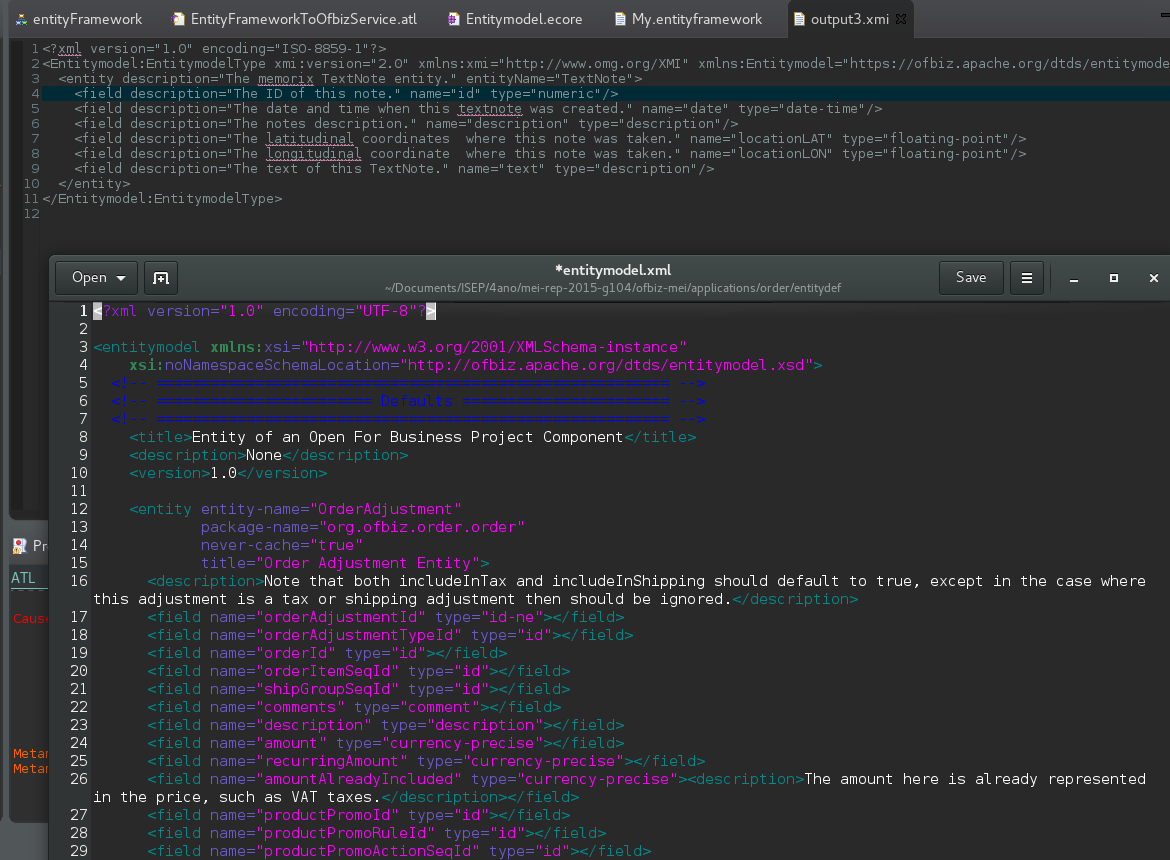

I'm looking to reverse engineer the ofbiz entity xml model to an ecore model. The reason for this is that i want to create my own ecore model and later map it to the ofbiz entity model using ATL.
The entity model xml schema is located here:
ofbiz.apache.org/dtds/entitymodel.xsd
I have successfully reverse engineered the model, however I've noticed that it changes the names of some attributes, which are invalid.
For example, the name 'entity-name' is changed to entityName. Additionally, the XML description xml tag stops being a stand alone tag and becomes an attribute of the parent node.
This is demonstrated in the screenshot i've attached, below we have a valid ofbiz entity model, with the correct 'entity-name' attribute inside the entity tag, and also the correct description tag.
Above the editor, we have the generated output from my model to the reverse engineered ecore model via an ATL transformation.  Notice it is incorrect because the entity-name tag attribute inside entity has been changed to entityName, and the description xml tag is now an attribute.
How could i fix this ?
Thank you for your time!

Humberto,
Comments below.
On 30/11/2015 9:08 PM, Humberto Carvalho wrote:
> Hello !
The original XML names are recorded as annotations.  They can be
accessed, using ExtendedMetaData, e.g.,
ExtendedMetaData.INSTANCE.getName(eStructuralFeature).
Yes, elements and attributes of simple type map to EAttributes.
It's using an XMI serialization.
Are you generating a model for this?   Even if not, try generating a
model for it and look at the generated XyzResourceFactoryImpl. You'll
want to register a resource factory that creates resources with these
load and save options if you want the serialization to conform to the
original XML Schema.

Humberto,
Comments below.
On 01/12/2015 9:35 PM, Humberto Carvalho wrote:
> Hi Ed Merks, thank you for you reply!
> I've generated the model for the OfbizEntity model, and added the following code to the EntityModelResourceFactoryImpl.java
> result.getDefaultLoadOptions().put(XMLResource.OPTION_RECORD_ANY_TYPE_NAMESPACE_DECLARATIONS, Boolean.TRUE);
> result.getDefaultSaveOptions().put(XMLResource.OPTION_RECORD_ANY_TYPE_NAMESPACE_DECLARATIONS, Boolean.TRUE);
The resource factory for model generated from an XML Schema generally
looks like this:
     public Resource createResource(URI uri) {
         XMLResource result = new XyzResourceImpl(uri);
result.getDefaultSaveOptions().put(XMLResource.OPTION_EXTENDED_META_DATA, Boolean.TRUE);
result.getDefaultLoadOptions().put(XMLResource.OPTION_EXTENDED_META_DATA, Boolean.TRUE);
result.getDefaultSaveOptions().put(XMLResource.OPTION_SCHEMA_LOCATION,
Boolean.TRUE);
result.getDefaultLoadOptions().put(XMLResource.OPTION_USE_ENCODED_ATTRIBUTE_STYLE,
Boolean.TRUE);
result.getDefaultSaveOptions().put(XMLResource.OPTION_USE_ENCODED_ATTRIBUTE_STYLE,
Boolean.TRUE);
result.getDefaultLoadOptions().put(XMLResource.OPTION_USE_LEXICAL_HANDLER,
Boolean.TRUE);
         return result;
> If i generate an instance of this ecore model via the generated editor, the outputted code is correct.

I can't help you with ATL, but if you're not getting the right result,
it implies you're not using the right resource factory to create the
result you're saving.  It's clear the above is being saved with a
resource created by the default XMIResourceFactoryImpl.
