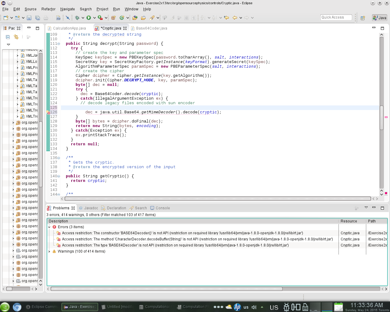

But unfortunately the bug is still there. Probably something else is doing this but erroneously pointing me to this line. I do not know. It is really weird.
see the attachment.
I will try a banned method which is disabling eclipse to do that.
