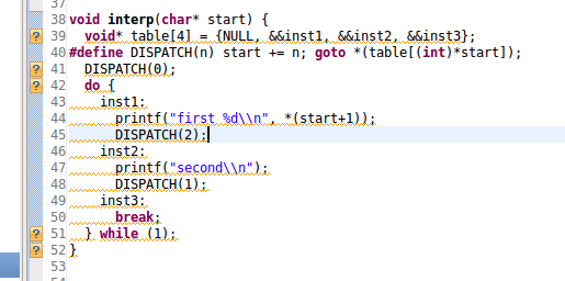

Using Indigo with CDT.
Attached screen shot shows syntax errors indicated in code that compiles without warnings or errors.
The computed goto's seem to choke the editor?
Am I missing an Eclipse setting?

Well, there is an error on the line 39, before the goto.

Yes, for some reason Eclipse shows that there is an error.
However, the compiler does not. That code will compile.
What is the error? How can it be fixed?

The double ambersand "&&inst1" confuses the parser (and me too Razz ).

Harry,
Just tried the __GXX_EXPERIMENTAL_CXX0X__ and "-std=c++0x" suggestions in various combinations with no luck.
My project is a 'C' project (not C++), and if you put "-std=c++0x" in the compiler command line, you get a message to the effect that the switch only works with C++.
Saw another post where someone commented:
"Did this remove spurious editor errors? I have no problem with compiling, and new std types are recognised, but I can't get rid of editor syntax errors for range based for loops and rvalue references &&. juanchopanza May 3 at 13:09"
Maybe there's no workaround?
