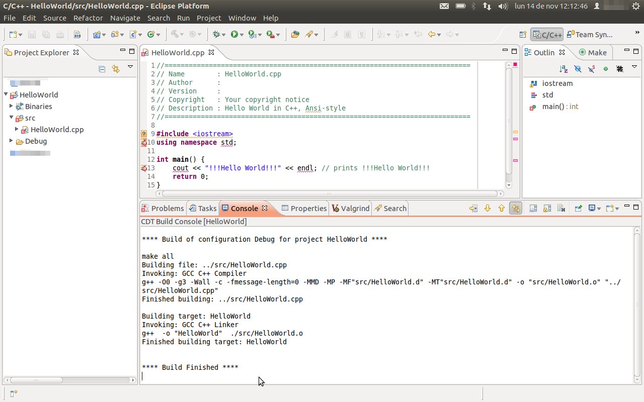

More information, I try to compile the default Hello World:
The console view of eclipse says:
index.php/fa/6136/0/

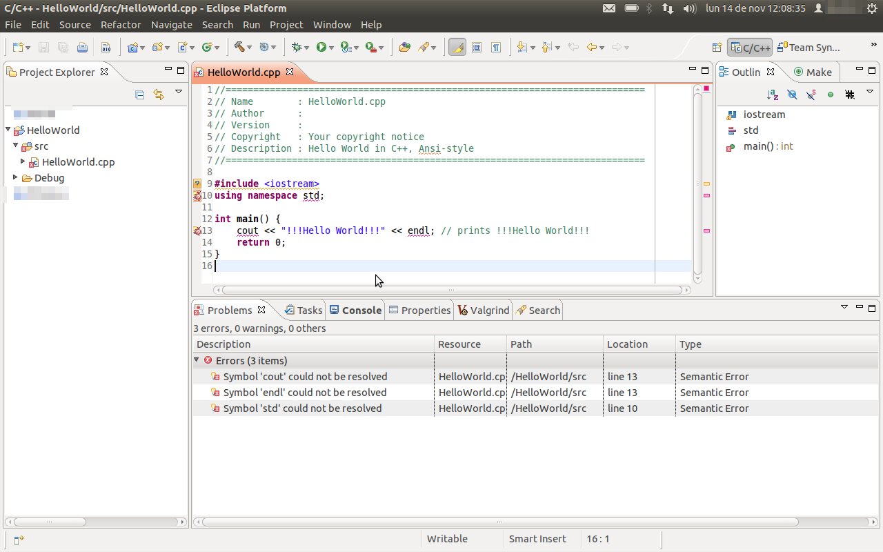

But the Problems View says:
index.php/fa/6135/0/
I can ejecute the application but eclipse continue displaying errors.
  • Attachment: img2.jpg
    (Size: 132.50KB, Downloaded 93578 times)
  • Attachment: img3.jpg
    (Size: 140.78KB, Downloaded 94570 times)

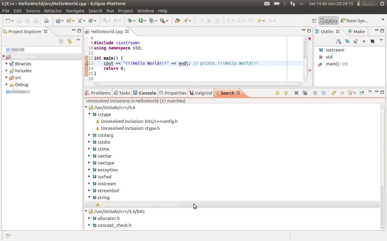

I've noticed there is some kind of indexer, so I asked it to tell me the unresolved inclusions. It says that it couldn't find a file that should be inside bits, that is a folder inside the path.
I search for that folder and the "c++config.h" file that string needs to work is missing. That isn't an eclipse error.
Perharps I'm including an incorrect folder.
There is also a 4.6 version of c++ but it also hasn't the missing file.
index.php/fa/6138/0/

  • Attachment: img4.jpg
    (Size: 111.98KB, Downloaded 91978 times)
