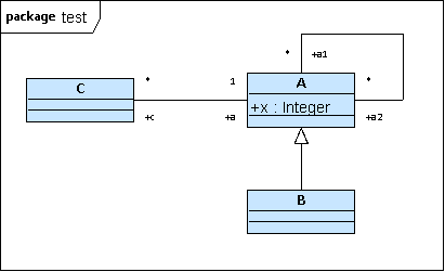

See the attached picture of a UML model. The mtl
// Associations:
[for (p : Property | c.getAssociations().memberEnd)]
// - [p.name/]
[/for]
// Attributes:
[for (p : Property | c.getAllAttributes())]
// - [p.name/]
[/for]
"renders"
for A:
// Associations:
// - a2
// - c
// - a1
// - a
// Attributes:
// - x
for B:
// Associations:
// Attributes:
// - x
for C:
// Associations:
// - c
// - a
// Attributes:
How should I change mtl to make it "render"
- only the other end of associations and
- only the declared attributes, not the inherited ones
? In other words:
for A:
// Associations:
// - a2
// - c
// - a1
// Attributes:
// - x
for B:
// Associations:
// Attributes:
for C:
// Associations:
// - a
// Attributes:
Harri

Actually the solution above does not resolve the issue because we don't know in which direction the associations are drawn.

I think that it would be better to check the property source (p.class) instead of the property target (p.type), in order to include it or not into the generated code.
This problem is typically a UML metamodel question. Its solution is in the OMG's UML specifications.
