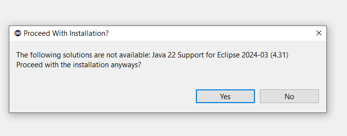

When I try to install "Java 22 Support" I am getting:
index.php/fa/44072/0/

Are you using Eclipse 2024-03? Are there entries in the Error Log view? Does the log in your workspace say something about the failed installation attempt?

From the log:
!SESSION 2024-03-19 21:43:57.747 -----------------------------------------------
eclipse.buildId=4.31.0.I20240229-0520
java.version=22
BootLoader constants: OS=win32, ARCH=x86_64, WS=win32, NL=en_US
Command-line arguments: -os win32 -ws win32 -arch x86_64
!ENTRY org.eclipse.epp.mpc.ui 1 0 2024-03-19 21:46:11.365
!MESSAGE Performing Marketplace install request from https://marketplace.eclipse.org/marketplace-client-intro?mpc_install=5585660
!ENTRY org.eclipse.epp.mpc.ui 4 0 2024-03-19 21:46:52.684
!MESSAGE The following solutions are not available: Java 22 Support for Eclipse 2024-03 (4.31) (id=org.eclipse.jdt.java22patch.feature.group, org.eclipse.jdt.java22patch.source.feature.group, site=https://download.eclipse.org/eclipse/updates/4.31-P-builds/)

Update:
I managed to install Java 22 Support via https://download.eclipse.org/eclipse/updates/4.31-P-builds/P20240320-0110/ update site.

Update:
There was an update today 2024-03-20 11:33:16 GMT+2 That seems to solve my problems.
