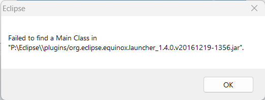

Re: How to Silently Install /Deploy Eclipse IDE for Enterprise Java and Web Developers [message #1866402 is a reply to message #1853083] Tue, 28 May 2024 17:08 Go to previous messageGo to next message
What about the message "Failed to find a Main Class?"
Re: How to Silently Install /Deploy Eclipse IDE for Enterprise Java and Web Developers [message #1866405 is a reply to message #1866402] Tue, 28 May 2024 19:11 Go to previous message
Steve Upson wrote on Tue, 28 May 2024 17:08
I would question why you're trying to install a 6 year old release, and whether p: is a local disk.
