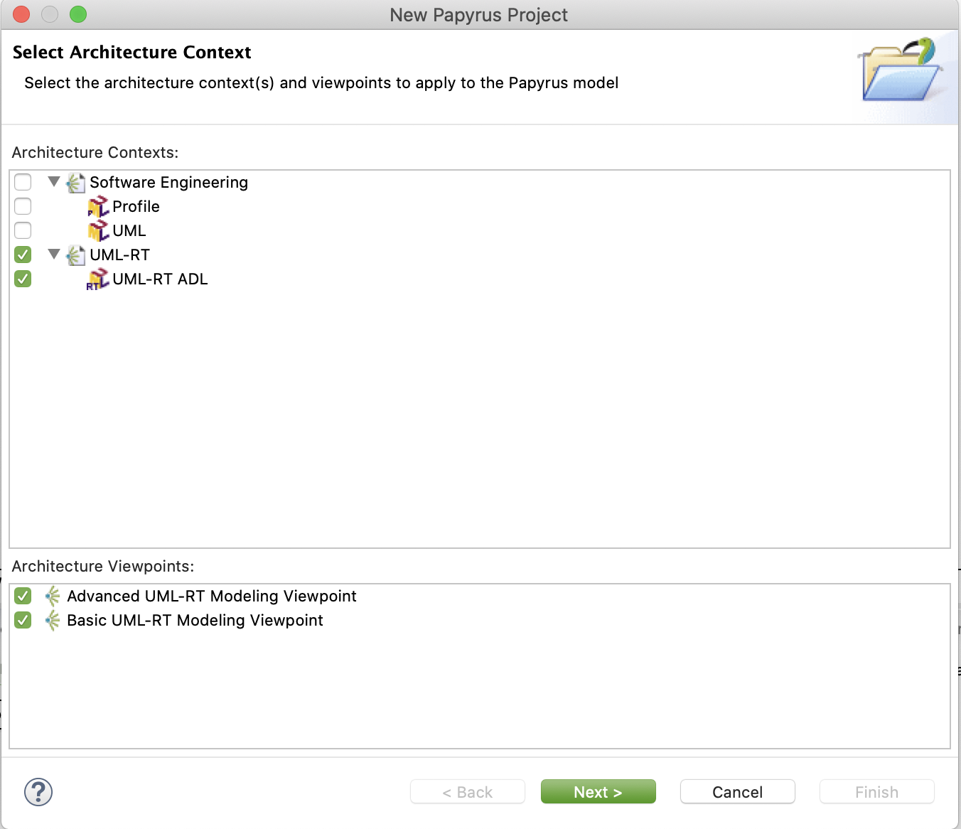

1) Ensure you select the UML-RT ADL Architecture Context and both the Basic and Advanced Architecture viewpoints. Click [Next]

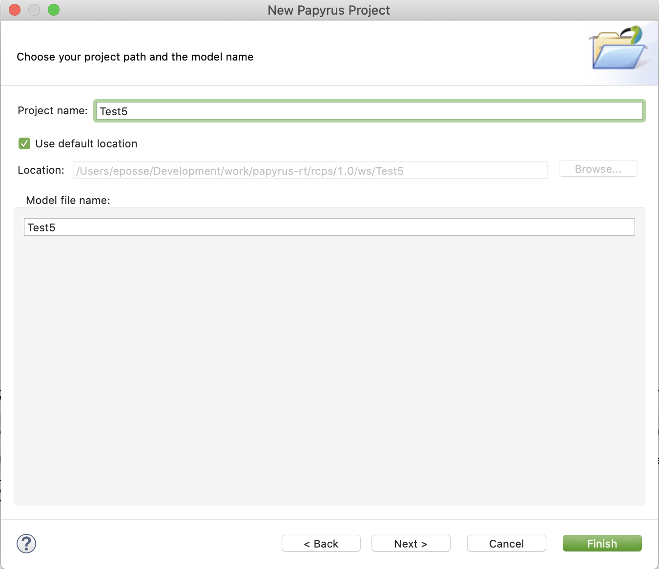

2) Select the name and location. Click [Next]
