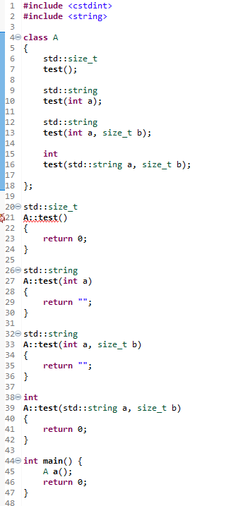

I was trying to clean all warnings in eclipse and I can't deal with issue below.
When I have a method which as a return value has size_t this cause parsing error. I think I have all paths pointing to the right place.
Currently I use this version, but it applies to older version of Eclipse too.
Eclipse IDE for C/C++ Developers
Version: 2020-03 (4.15.0)
Build id: 20200313-1211

#include <cstdint>
#include <string>
class A
	std::size_t
	test();
	std::string
	test(int a);
	std::string
	test(int a, size_t b);
	int
	test(std::string a, size_t b);
std::size_t
A::test()
	return 0;
std::string
A::test(int a)
	return "";
std::string
A::test(int a, size_t b)
	return "";
int
A::test(std::string a, size_t b)
	return 0;
int main() {
	A a();
    return 0;

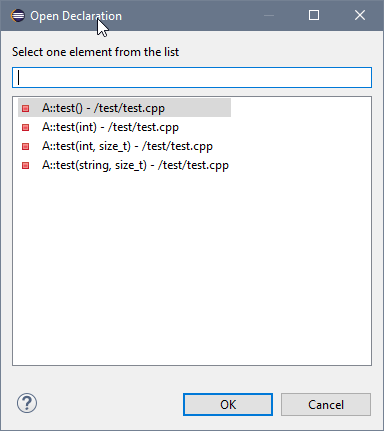

I presented so long code, because I wanted to show the problem with opening declaration (parser is confused). It happens only when there is more than one method with the same name.
I've attached parser.log which shows this error:
A declaration could not be found for this member definition: test in file C:\Users\---\eclipse-workspace\test\test.cpp:11

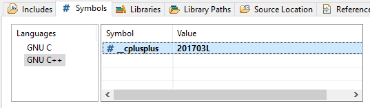

I haven't used MinGW in a long time.
It seems unusual that __cplusplus would show up in the Symbols dialog.
It's compiler builtin value.
Did you put it there?
If not, where are the rest of the builtin macros?
If so, why?
It may be causing a conflict with the library definitions.
There are other compiler builtins which change with the dialect.
The same with the includes.

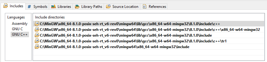

Paths and Symbols is supposed to contain paths to YOUR definitions and not the compiler supplier's.
Why aren't these in the compiler builtins list ?
Project --> Properties --> C/C++ General --> Preprocessor Include Paths, Macros etc.

In short words. I had a problem with wrong path to MinGW in PATH.
When I fixed this and removed unnecessary Symbols and Includes it started working!
