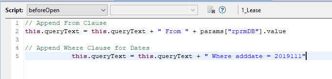

I think you should be able to do it in the beforeOpen method of the dataset. Set the Select Statements as usual and then extend the query in the beforeOpen method. (See screenshot)

Thanks Jerry, this is exactly what I was looking for. Cheers!
