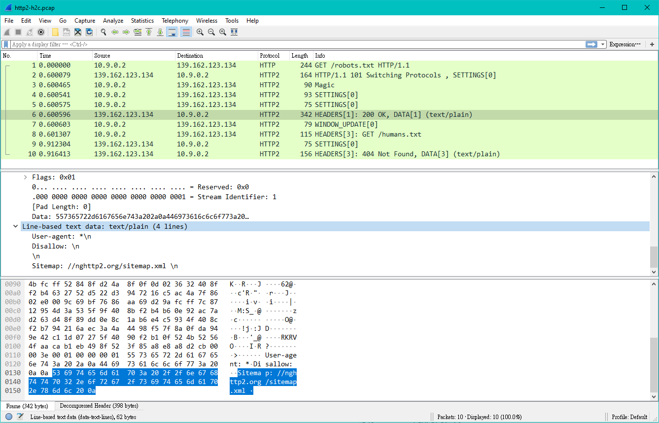

The same nghttp2.org has been used as before , with a request towards /httpbin/ip.
A browser request to this URL (https://nghttp2.org/httpbin/ip ) returns:
  "origin": "91.82.100.59"
The same as seen by Titan:
05:26:48.162027 HTTP2.ttcn:458 received something   :{
    data_frame := {
        stream_id := 1,
        end_stream_flag := true,
        data := '7B0A2020226F726967696E223A202239312E38322E3130302E3539220A7D0A'O ("{
  \"origin\": \"91.82.100.59\"
        padding := omit

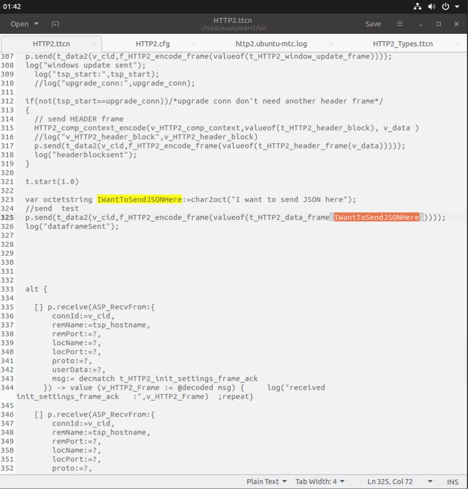

Re: Support for HTTP/2 in Eclipse Titan- with a twist [message #1814362 is a reply to message #1814317] Tue, 10 September 2019 05:06 Go to previous messageGo to next message

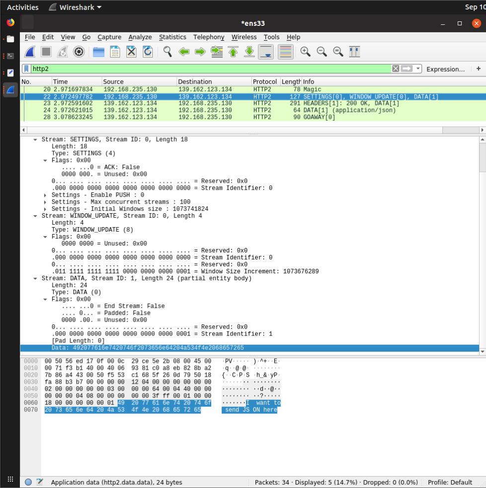

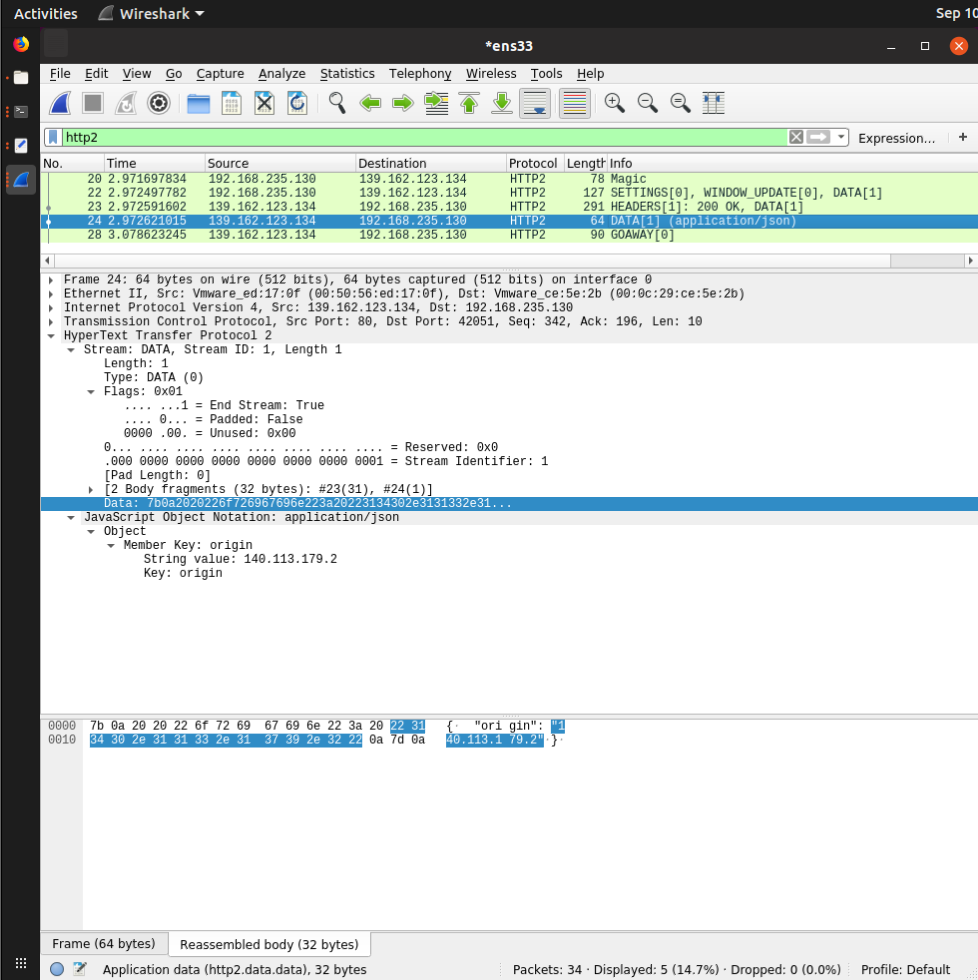

Hi Elemer,
Thank you very much for the resource you provided, which really helps a lot for me to acquire knowledge of http2!
I have do some test by trying to modify the code like your advise.
In the result of today's experiments, I add a couple lines like below:
index.php/fa/36250/0/
and I got that packet in wireshark like this:
index.php/fa/36251/0/
I was wondering isn't that text should be encoded in to binary in http2?
But I downloaded the example http2 packets provided by wireshark,
index.php/fa/36253/0/
that means its correct to see the text I sent directly in wireshark, isn't it?
Even more, I noticed that the test server sent a json dataframe to me!
index.php/fa/36252/0/
Does that means if I import some protocol modules which encode JSON data to octestring, and sent it as data frame, I can see its been recognized as json in wireshark like this?
Thanks for your patience and time,
Best regards
Sean
Re: Support for HTTP/2 in Eclipse Titan- with a twist [message #1814371 is a reply to message #1814362] Tue, 10 September 2019 07:02 Go to previous messageGo to next message
Hi Sean, you are absolutely right:
When a TTCN-3 JSON template/variable is encoded, first the corresponding characterstring is assembled and then this is converted to octetstring , same as char2oct. So it's perfectly normal that the JSON string appears and is readable in wireshark.
Also, yes , all you need is to import one or more or all 5G JSON protocol modules and you can start talking to the other node.
Congratulations, you are a quick learner, and this subject is not the simplest one.
Best regards
Elemer

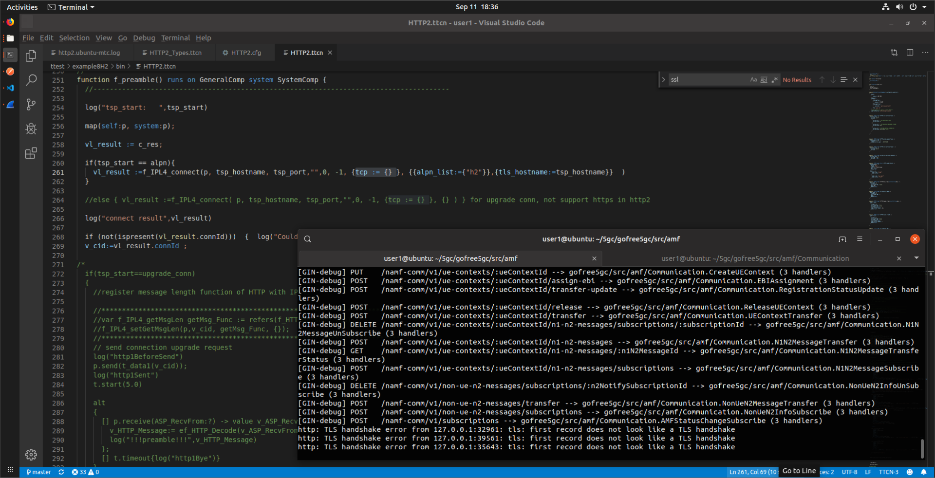

Re: Support for HTTP/2 in Eclipse Titan- with a twist [message #1814450 is a reply to message #1814446] Wed, 11 September 2019 10:43 Go to previous messageGo to next message
Hi Elemer,
Thanks for your reply,
turns out I have been too silly to forget remaking it, maybe need some redbull to stimulate my brain lol.
Port has been changed successfully by adjusting f_IPL4_connect, thanks again.
However, things would never been easy, I suddenly founds out that my colleges' AMF server only takes http"s" connection.
Gotta working on that "s" for tomorrow's progression report, they don't believe that it is not enough time to build a namf test in one week, no sleeping tonight I guess.
P.S. is this the right direction for https ?https://www.eclipse.org/forums/index.php/m/1755290/#msg_1755290
P.S.2(<- is that legit usage of P.S. ? Whatever)
Does all http2 server support all three kinds of connection establishment?
if yes, would upgrade connection be easier to make it https than http, since it's start with http/1.1 and alpn is http2?
---update---
hmm, I see, alpn is for https in http2., from here https://www.eclipse.org/forums/index.php/m/1783014/?srch=SSL#msg_1783014
Best regards
Sean

Re: Support for HTTP/2 in Eclipse Titan- with a twist [message #1814457 is a reply to message #1814455] Wed, 11 September 2019 12:43 Go to previous messageGo to next message
Hi Elemer,
Thanks for your reply, it is nice to hear that change to alpn would make https in default.
It would definitely saved a lot of time, maybe I could go to sleep soon.
However new problem appear and I'm working on this connection error.
09:34:54.227645 HTTP2.ttcn:260 entering f__IPL4__PROVIDER__connect: :0 -> nghttp2.org:80 / SSL
09:34:55.122063 HTTP2.ttcn:265 connect result{ errorCode := ERROR_SOCKET (4), connId := omit, os_error_code := 0, os_error_text := "Success" }
Gotta trace this connect result.
Best regards
Sean

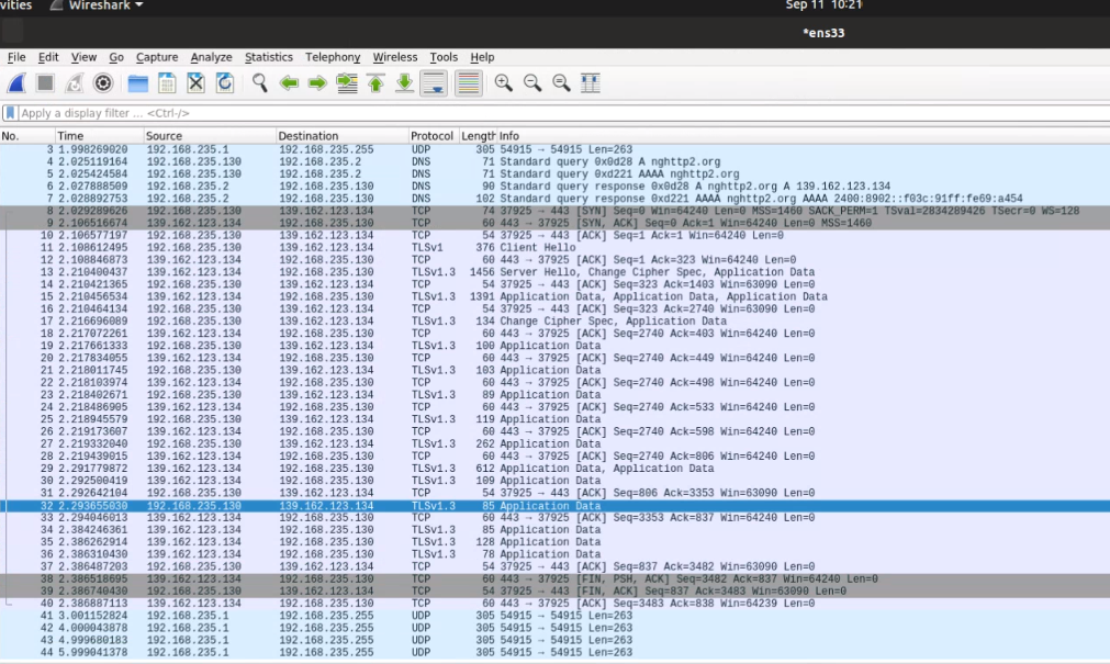

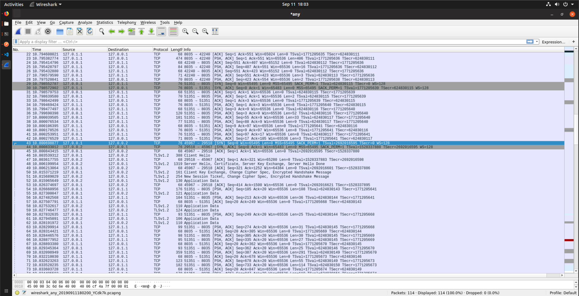

Re: Support for HTTP/2 in Eclipse Titan- with a twist [message #1814461 is a reply to message #1814459] Wed, 11 September 2019 13:06 Go to previous messageGo to next message
Hi Elemer,
Yeah, I added this HTTP2.tsp_port :=80 in cfg and in HTTP2.ttcn, because the port was 80 in upgrade conn...
oh wait, maybe I should try 443?
---update---
Yeah, 443 works.
---update 2---
Seems like https would encrypted everythings that even wire shark could not know what it is?
index.php/fa/36271/0/
However I can know that frame have been successfully sent and receive in log files
---update 3---

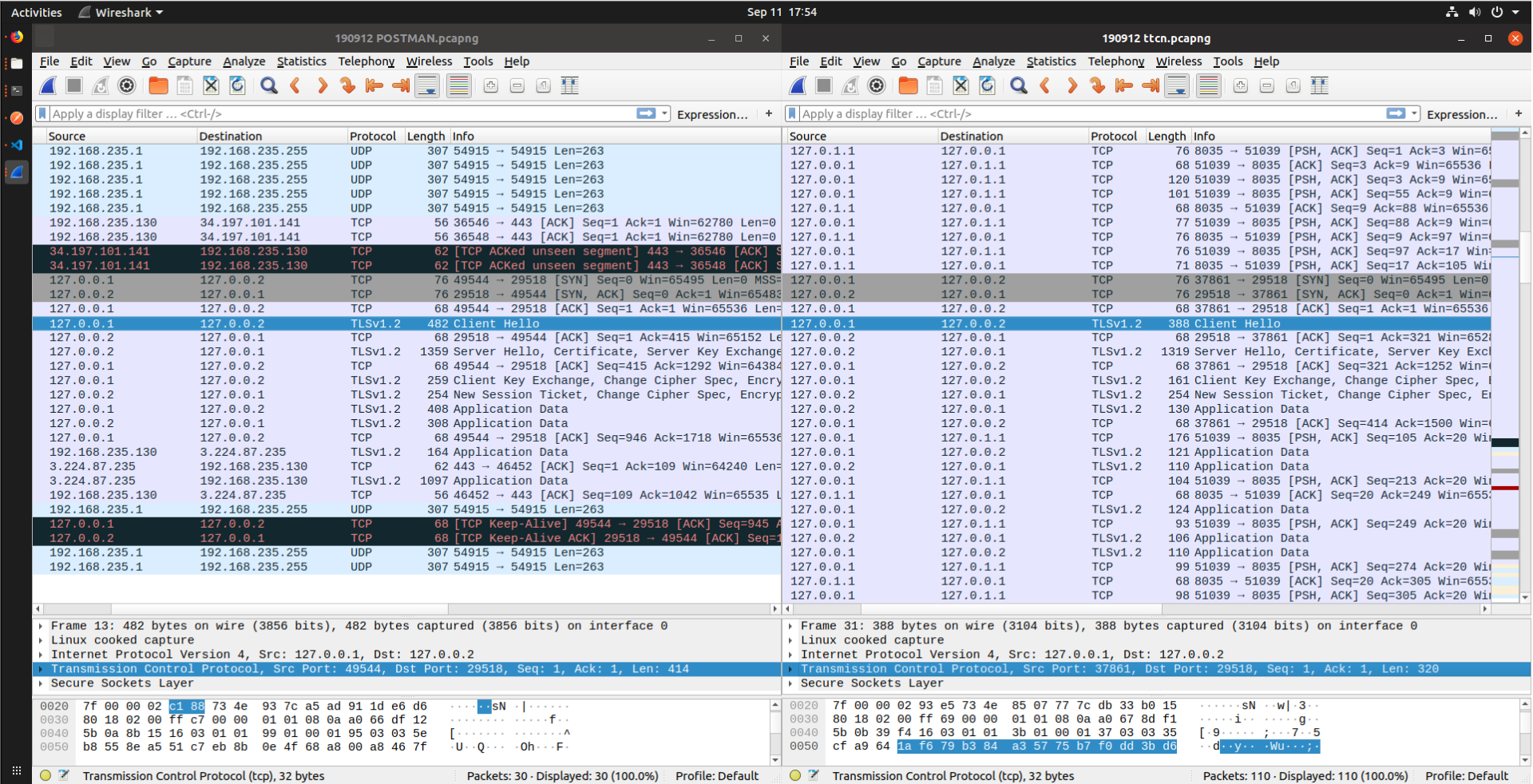

Its really weird that when I change port to 29513, connection successfully datafrme too,
but my AMF server shows that he diddn't receive any thing.
But if I used POSTMAN to send message, it could react properly,
what ever this problem is, I gotta go to sleep first.
Too damn tired.
---update 4---
I think I found the problem,
it is POSTMAN on the left and ttcn on the right,
index.php/fa/36272/0/
when in ttcn, my port should be TCPPort := 8035 in cfg.
but obviously it is not.
Even more, it changes every time.
index.php/fa/36273/0/
---update 5---
No I don't think port is the problem now.
Just came up with one Idea that I should disable ssl certification in postman to make our server response,
so I change ssl to tcp:
index.php/fa/36274/0/
wow server finally showing something.
now, how to make that looks like tls handshake?
---update 6---
That is not tcp, it should be ssl, but I should set *.p.ssl_verify_certificate := "No" in cfg, now the handshake looks right.
Now the problem is, if I sent request to different URI, the server can response a 400 to ttcn, however, nothing happened when /namf-comm/v1/ue-contexts/456/transfer.
Turns out it is because I didn't set content type to server.
How to set content type in http2?
