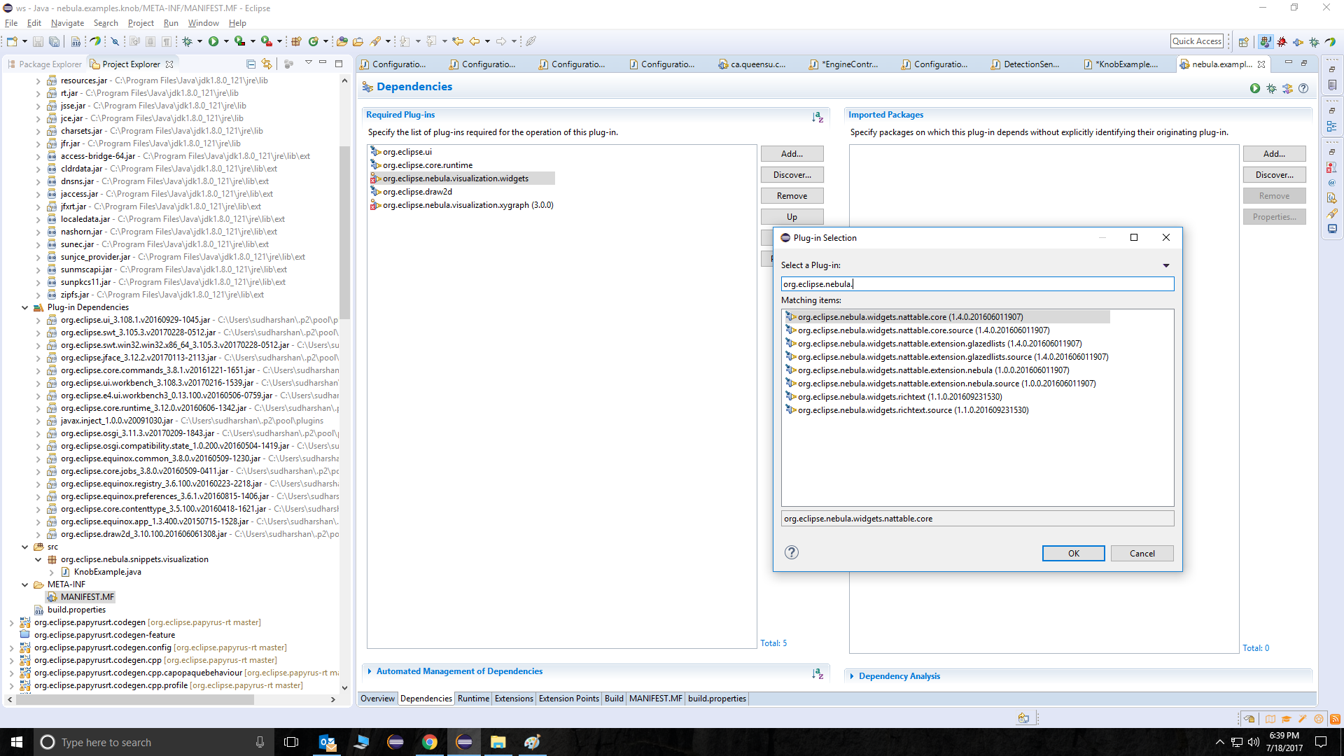

- I installed the required software from the link : http://download.eclipse.org/nebula/releases/latest. In addition to this, I have also imported all the required plug-ins available for Eclipse Nebula (PIC attached). However, i do not find any plug-in for Nebula visualization. Hence my eclipse is not able to resolve the import statement "import org.eclipse.nebula.visualization.widgets.figures.KnobFigure;"

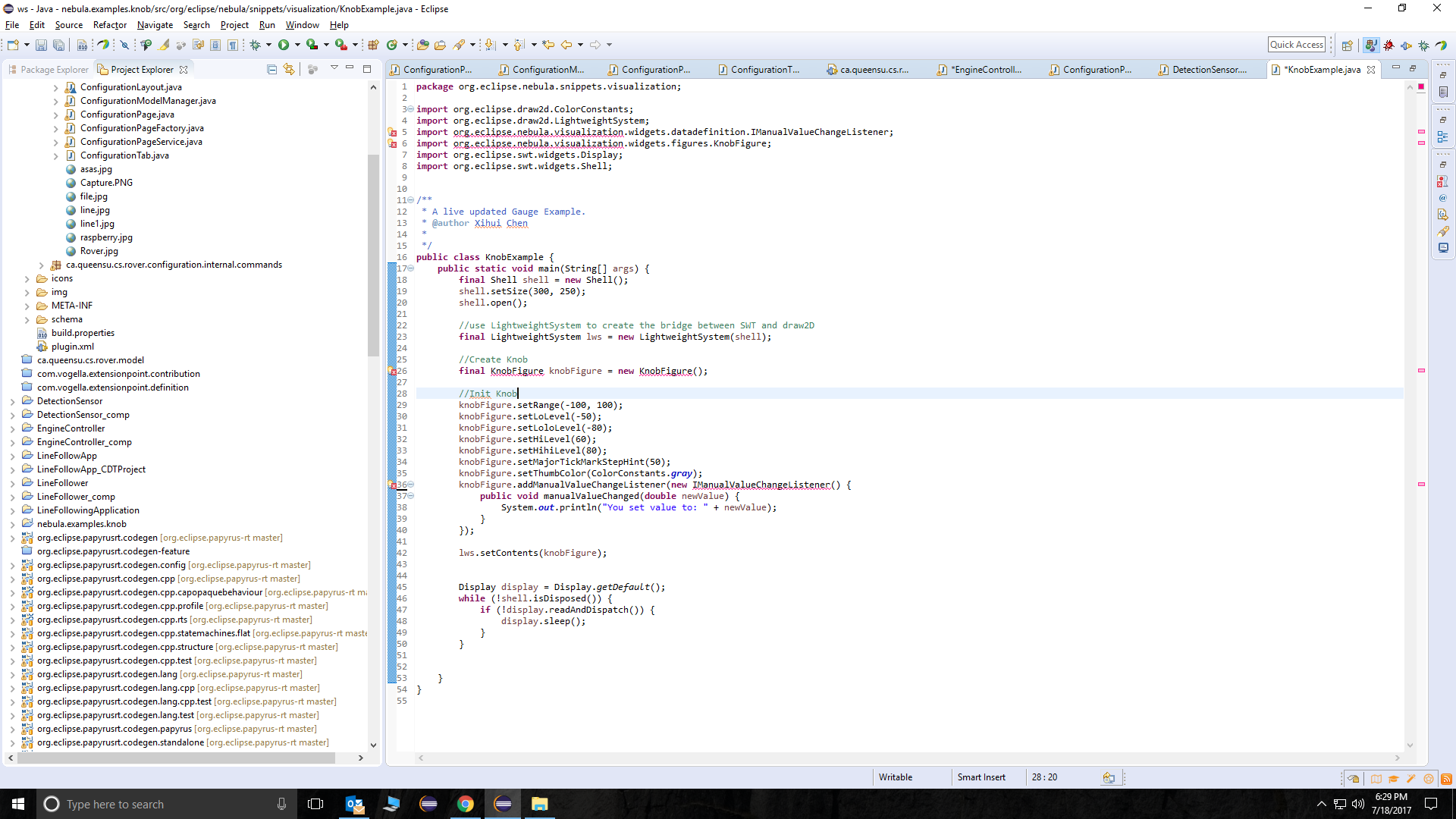

Thank you for the help. But i still get the same error, the import statements "import org.eclipse.nebula.visualization.widgets.datadefinition.IManualValueChangeListener" ;
and import org.eclipse.nebula.visualization.widgets.figures.KnobFigure;" is not recognized by eclipse. (PIC ATTACHED)
Also in the plugin-dependencies i observed that, my plugin- "org.eclipse.nebula.visulaization.widgets" is not resolved (PIC attached) nor am i able to add them.
Sudharshan

Re: Eclipse unable to resolve import statement [message #1768442 is a reply to message #1768441] Tue, 18 July 2017 15:00 Go to previous messageGo to next message
They are already added in plugin.xml. You did not install the visualization widgets. Please install them from [1] or add [1] to your target platform.
Wim
[1] http://download.eclipse.org/nebula/releases/latest.
