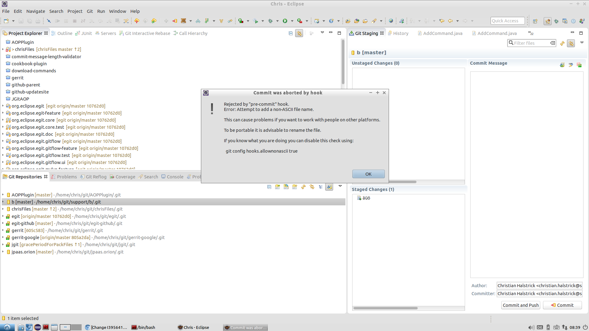

Re: Git hooks in eclipse [message #1698499 is a reply to message #1698215] Tue, 16 June 2015 02:42 Go to previous messageGo to next message
simply use it. E.g. rename in your repo <root>/.git/hooks/pre-commit.sample to <root>/.git/hooks/pre-commit . Then from EGit to to commit a file with non-ascii path and you'll see the error message coming from this hook.
  • Attachment: lub14.png
    (Size: 248.02KB, Downloaded 1729 times)

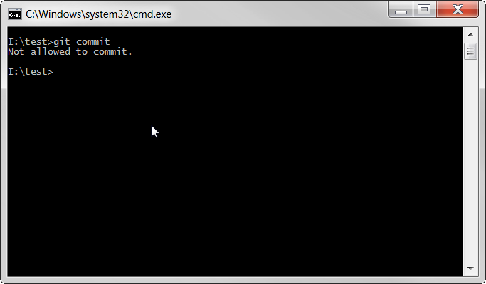

Re: Git hooks in eclipse [message #1699154 is a reply to message #1698542] Mon, 22 June 2015 04:02 Go to previous messageGo to next message
I have no trouble running git hooks, the Git bash, git from command line, tortoiseGit and other programms respond to it as expected. (Note that in my previous message I used unfortunate wording when referring to the clients I'm using.)
If I understand correctly, Egit implemented all git commands natively. If this is correct, than changing git client wouldn't change anything in how Eclipse performs git commands.
Did you manage to get git hooks working in Eclipse in Windows using cygwin?
I use this script to test:
#!/bin/sh
cat <<\EOF
Not allowed to commit.
EOF
exit 1
