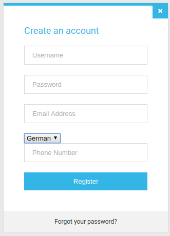

I've got another requirement popping up in my mind: How would be a user registration dialog be implemented in that scenario?
Peter
Re: SpringBoot and EclipseScout [message #1749054 is a reply to message #1749053] Thu, 01 December 2016 08:56 Go to previous messageGo to next message
why don't you come up with a wireframe sketch Wink
Re: SpringBoot and EclipseScout [message #1749121 is a reply to message #1749054] Fri, 02 December 2016 01:03 Go to previous messageGo to next message
your wish is my command Smile It's not nice. But it also shows a dopdown for language settings. Just to make things a little bit more challenging.
Thanks a lot!
Peter
