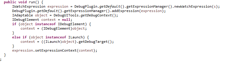

I have been working on a module that interacts with the Eclipse debugger programmatically.
So far I have been able to perform all the required actions I have needed without having to invoke any implementation specific code, and this has worked with the CDT/DSF/TCF debugger.
However, I am now attempting to access expressions vie the IExpressionsManager interface and this seems to be problematic with the TCF debugger.
While I am able to add IExpression objects to the "expressions" view via the IExpressionsManager, and the values in the view are displayed properly, The IExpression object I have has a null value and context.
I found the following code in TCFNodeExpression.Java which seems to attempt to deal with this, however after observing execution, it seems that Object returned by the getDebugContext() method is a TCFNodeExecContext, which does not implement IDebugElement or ILaunch, and as such the IExpression context remains null.
index.php/fa/27703/0/
Is there some other way for me to get an expression's value without having to specifically invoke a TCFTask?

In TCF, IExpression.getValue(), IValue, IVariable are not supported. setExpressionContext() call appears to be result of sloppy copy/pasting. You have to use ITCFExpression.getValue() method to get value of the expression.
