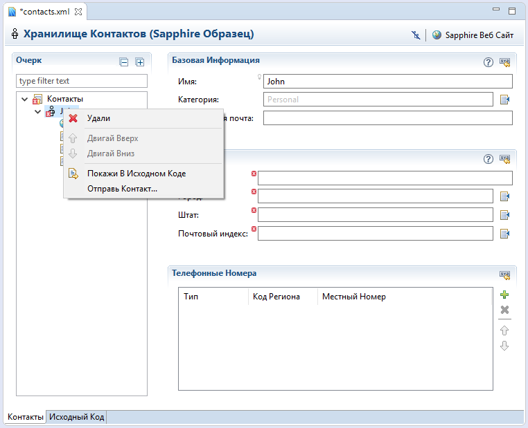

I have spent several days going over Sapphire localization and fixing a few regressions. The result of this effort can be seen in the following screen capture that shows Sapphire contacts sample running with Russian localization.
index.php/fa/26744/0/
The fixes are available on 8.3, 9.1 and 10 code lines, which are all available from Sapphire build server.
https://hudson.eclipse.org/sapphire/
