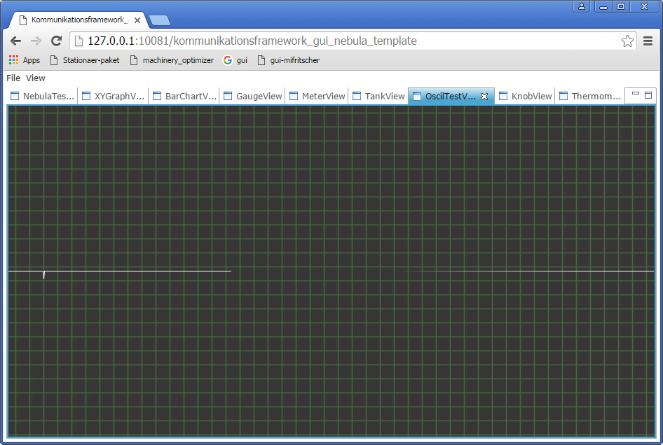

* Oscilloscope: Needs functionality to get a GC from a image instead of a canvas. Should be quite easy for the most usecases, because this can be done on the servers side. But luckily, it is only used for writing upright diagramm labels, so I just disabled it. Works very smooth, even animations.
index.php/fa/24796/0/

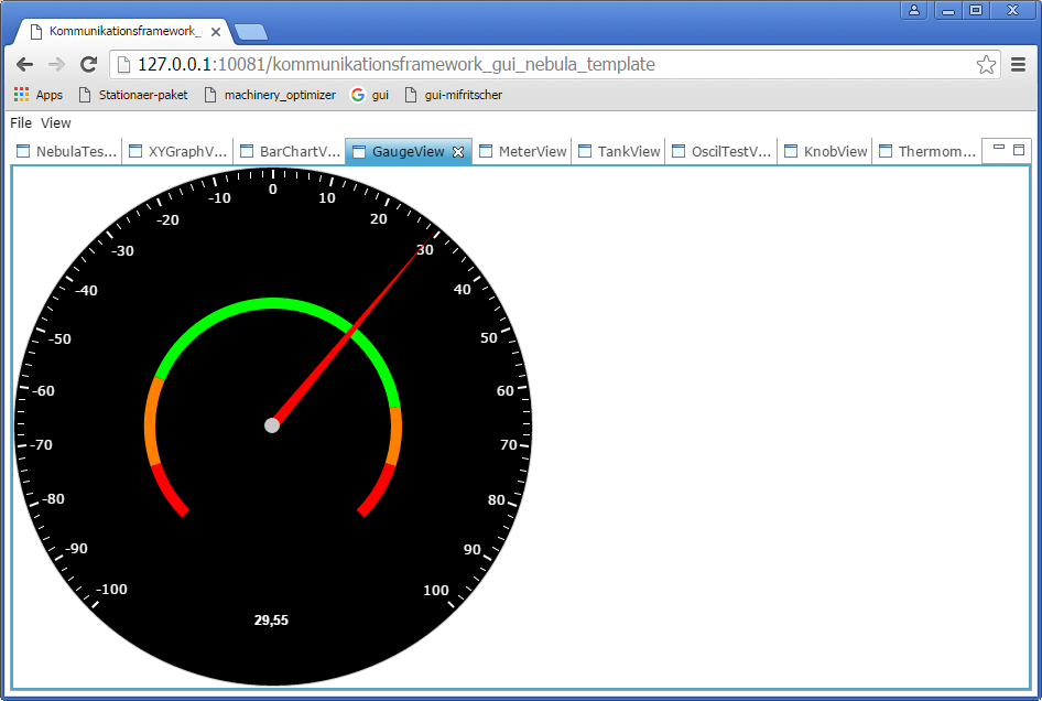

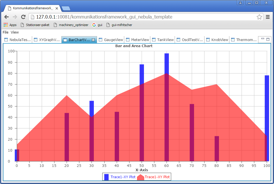

* Visualisation (I tried xygraph, tank, temperature, speed view etc.): works, but flickers on update. Perhaps this could be optimized using a double buffer strategy on the client side with a default transparent picture. Interactions are working. The flickering could be tolerable for some usecases.
index.php/fa/24794/0/
index.php/fa/24795/0/

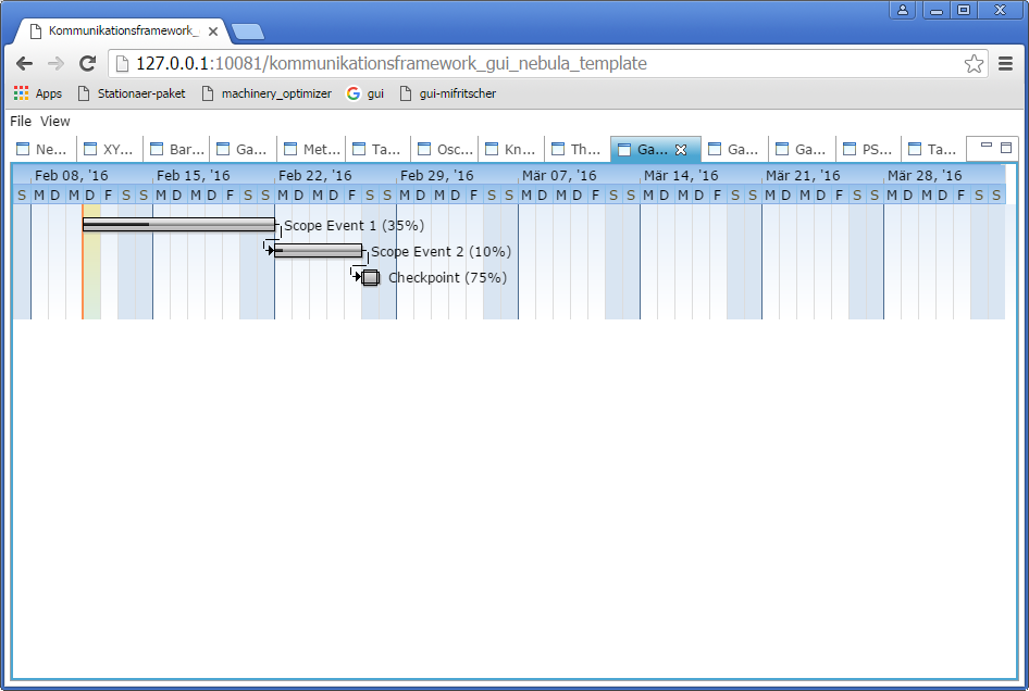

Re: RAP and Nebula: Impressive! [message #1723072 is a reply to message #1721558] Thu, 11 February 2016 06:32 Go to previous messageGo to next message
And here is the screenshot for the gant chart:
index.php/fa/24956/0/
  • Attachment: Gant.png
    (Size: 52.56KB, Downloaded 1488 times)
[Updated on: Thu, 11 February 2016 06:33] by Moderator
