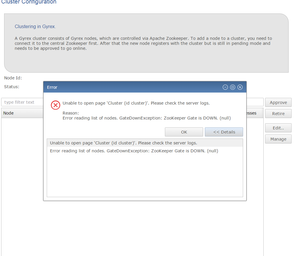

Now I can started the dev environment now. While, I got an error when I try to access the cluster management page in the web console (http://localhost:3110).
The screenshot for the error is attached. And the detail log while starting the environment is as below:

19:58:52.747 [qtp1611116091-61] ERROR org.eclipse.gyrex.rap.JFaceLog - Unable to open page 'Cluster (id cluster)'. Please check the server logs.
java.lang.RuntimeException: Error reading list of nodes. GateDownException: ZooKeeper Gate is DOWN. (null)
	at org.eclipse.gyrex.cloud.internal.admin.CloudManagerImpl.getOnlineNodes(CloudManagerImpl.java:164) ~[na:na]
	at sun.reflect.NativeMethodAccessorImpl.invoke0(Native Method) ~[na:1.7.0_79]
	at sun.reflect.NativeMethodAccessorImpl.invoke(Unknown Source) ~[na:1.7.0_79]

Caused by: org.eclipse.gyrex.cloud.internal.zk.GateDownException: ZooKeeper Gate is DOWN. (null)
	at org.eclipse.gyrex.cloud.internal.zk.ZooKeeperGate.get(ZooKeeperGate.java:137) ~[na:na]
	at org.eclipse.gyrex.cloud.internal.admin.CloudManagerImpl.getOnlineNodes(CloudManagerImpl.java:156) ~[na:na]
	... 75 common frames omitted
> at
> ~[na:na]
> at
> ~[na:na]
> 20:00:26.683 [Worker-1] DEBUG o.e.g.e.w.i.WebsocketEventTransport -
> Connecting online nodes for the event transport.
> 20:00:26.685 [Worker-1] WARN o.e.g.e.w.i.WebsocketEventTransport - An
> error occured while connecting online nodes for the event transport.
> Operation will be retried.
Is there some firewall active which could block connections?
-Gunnar
Gunnar Wagenknecht
gunnar@xxxxxxxx
