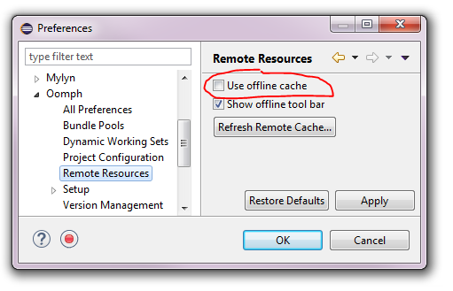

The TargletTask should behave just like you expect. If it doesn't I
see two possible reasons:<br>
<br>
1) Your version ranges are too narrow. It's unlikely, but how are
they specified?<br>
<br>
2) Oomph's offline mode is enabled. Make sure that the offline cache
is not used:<br>
<img src="https://www.eclipse.org/forums/index.php?t=getfile&amp;id=20465" alt=""><br>
<br>
A third reason could be that p2 itself has cached the repo contents
in memory. Does the problem persist after a restart of the IDE?<br>
<br>

Hi Eike,
thanks for your help.
I solved my problem with the following "work a round", whereas I don't know if it's a good solution.
I added the problematic P2 repository to the "P2 Director" in the hope that the meta data will be updated. And it works for my use case.
If I have the right understanding of Oomph, every bundle is stored in one central bundle pool and the P2 Director takes care of it. Seems to be so.
Maybe it's not the best solution...
