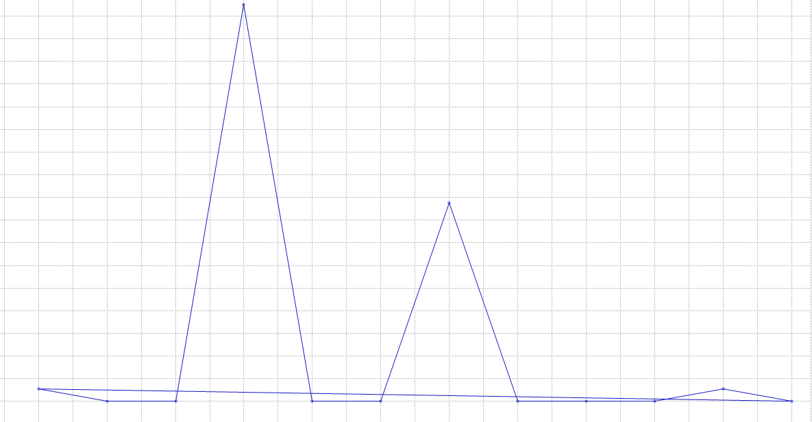

I have a question, i am using a trace that have the default trace type (SOLID_LANE) but i have an issue, with this type the graph join all the points included the final with the first point, and i dont want this.
Thanks.

Here is the code....

And the result image is:
index.php/fa/19937/0/
The way that i load the dataprovider is:
dataProvider.setCurrentXDataArray(datax);
if i use:
dataProvider.setCurrentXData(datax[i]);
the problem doesn't appear, but i need use the first option for more faster drawing.
Thanks. Regards.
  • Attachment: trace_bug.png
    (Size: 50.35KB, Downloaded 635 times)
[Updated on: Wed, 19 November 2014 14:31] by Moderator
Re: Trace Type SOLID_LANE join all points [message #1482292 is a reply to message #1478598] Fri, 21 November 2014 12:03 Go to previous messageGo to next message
The reason is that you set the same data twice in the for loop, so the second time when you set the same data, they are appended to the previous data, which will connect the last and first point.
Why are you using a for loop here? Could you just remove the for loop? You did help me find another bug: https://bugs.eclipse.org/bugs/show_bug.cgi?id=452686 . I have fixed it.
for (int i = 0; i < 2; i++)
dataProvider.setCurrentYDataArray(datay);
Xihui
Re: Trace Type SOLID_LANE join all points [message #1482406 is a reply to message #1482292] Fri, 21 November 2014 14:19 Go to previous message
The for cycle was because the graphic doesn't refresh all data from trace. But I test now without the for and in the second refresh join again the first with the last value.
How i can for get the last version of nebula with these bug fixes ?
Thanks.
Regards.
