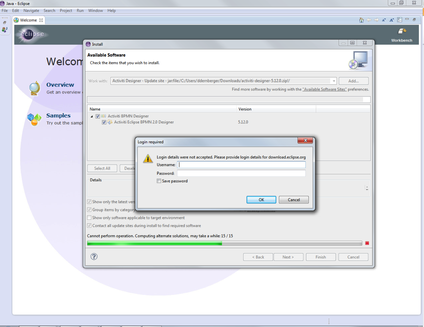

I received a new pc and now when I try to install Activiti through the install new software I am being asked for a password to access Download.Eclipse.Org? I have tried several different password but nothing seems to work. Even set up account on here and tried it.
Not sure if the issue is related but I also seem to be missing some EMF files which may be why it is trying to access eclipse.org?

The password request would not be "coming from" Eclipse. Maybe a proxy,
if you are behind one.
But, I've sometimes see a "corrupt zip" (or, one with lines that were
too long) get confused and think it was a "signed zip"?
But, this should probably be a question you ask of Activiti ... since it
is their stuff you are trying to install? And, as far as I know, they do
something special?

Activiti (whatever that is) is not affiliated with eclipse.org at all. Can you post a screenshot of the password dialog?
If they are asking for a password for download.eclipse.org, we will investigate this.
Re: Trying to Install New Software, Eclipse is asking for a password [message #1472298 is a reply to message #1472266] Thu, 13 November 2014 14:24 Go to previous messageGo to next message
I have attached the password box I am getting. I have compared another user with my set up and have noticed I do not have as many Eclipse Modeling Project plugins as she does. I am not sure if this is because Eclipse is not loading completely because I cannot get past this password.
If i do cancel out the password box it loads something and then provides this error:
Cannot complete the install because one or more required items could not be found.
Software being installed: Activiti Eclipse BPMN 2.0 Designer 5.12.0 (org.activiti.designer.feature.feature.group 5.12.0)
Missing requirement: Activiti Eclipse BPMN 2.0 Designer 5.12.0 (org.activiti.designer.feature.feature.group 5.12.0) requires 'org.eclipse.emf 2.6.0' but it could not be found

PLEEASE, do NOT attach pictures as Word documents!
Attached PNG of same, this only time.

<font face="DejaVu Sans Mono">You never did say if you are behind a
proxy. Even one that normally does not require a userid/password.
<br>
<br>
Part of the reason I ask is because of bug <br>
<a class="moz-txt-link-freetext" href="https://bugs.eclipse.org/bugs/show_bug.cgi?id=422665">https://bugs.eclipse.org/bugs/show_bug.cgi?id=422665</a>, <br>
where Eclipse/p2/ecf "thinks" it needs to authenticate the proxy
when it does not. And this occurs on Windows only, as far as I
know, so assume you are on Windows? And what version of Eclipse
does Activiti say it works with? "Luna" (Eclipse 4.4?) If
something prior to that, then this would not be the bug you are
hitting. <br>

This thread tackled the same problem. It looks like David is right: it's likely a problem with your proxy server.
http://forum.spring.io/forum/spring-projects/springsource-tool-suite/100711-login-required-to-add-plugins

You never did say if you are behind a proxy. Even one that normally does
https://bugs.eclipse.org/bugs/show_bug.cgi?id=422665,
where Eclipse/p2/ecf "thinks" it needs to authenticate the proxy when it
does not. And this occurs on Windows only, as far as I know, so assume
you are on Windows? And what version of Eclipse does Activiti say it
works with? "Luna" (Eclipse 4.4?) If something prior to that, then this
would not be the bug you are hitting.
A good way to test this, if you haven't already, it to install a "plain"
Eclipse SDK 4.4.1 (so all the other software is removed from the
equation) such as from
http://download.eclipse.org/eclipse/downloads/drops4/R-4.4.1-201409250400/#EclipseSDK
(getting appropriate 32 or 64 bit, based on your machine and your VM).
And then, under help, select "install new software", pick the repository
for .../releases/Luna
and try to install something from there ... Eclipse Git, XML Editor, or
something small :)
If you do get the prompt then, I'd say you are running into bug 422665
and you are "going through a proxy".
If you do not get the prompt, then I think you'll have to ask Activiti
what the best course of action is.
(Well, or try some of the work arounds, in bug 422665, if you have the
patience for it. :)
Good luck,

Thank you for all your suggestions. We were able to merge information from the standard version and the modeling version of Eclipse to get the missing EMF files loaded and it is now working.
This issue can be ended or closed.
