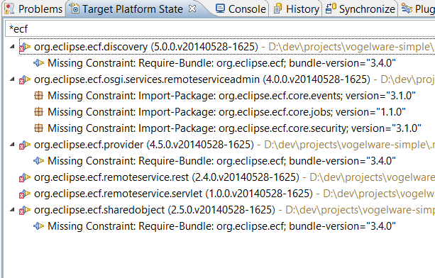

I have a target platform built using http://download.eclipse.org/rt/ecf/latest/site.p2
I included the ECF OSGi Remote Services SDK 3.8.1 feature with include required software unchecked. The base consumer fails with errors of unresolved bundles. The target platform shows missing dependencies to newer versions of the ECF platform (see image).
The version of org.eclipse.ecf in the target platform is 3.1.300v20110531-2218
org.eclipse.ecf v 3.4.0
org.eclipse.ecf.core.events v 3.1.0
org.eclipse.ecf.core.jobs v 1.1.0
org.eclipse.ecf.core.security v 3.1.0
What is the solution for these missing dependencies?
Hmmm. It appears that p2 is attempting to resolve the dependencies in the target platform via the old version of ECF (3.1.300).

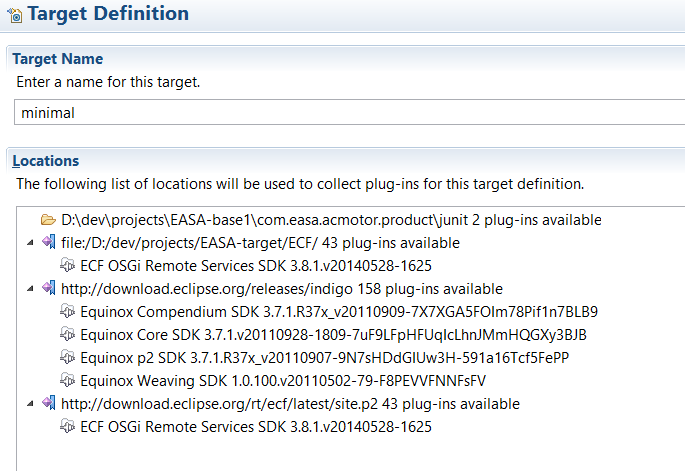

1) What version of Eclipse are you using?
Luna for the editor. However the target is based on RCP 3.7 (Indigo) as is Equinox since that is the client's platform
2) Are you currently choosing the active bundles in the target platform 'by hand' (by selecting the specific version of each bundle in the target platform that you want rather than having them chosen automatically. Have you tried that?
The only org.eclipse.ecf bundle is 3.1.300
3) How did you install the 3.8.1 version of ECF into the target platform?
Using the add software wizard that is part of the target platform editor.
On the Content tab of the target platform editor, I grouped by location. The only version of org.eclipse.ecf is 3.1.300 and is coming from the Equinox 3.7.1 SDKs. See image below for full target.
Is ECF compatible with a RCP 3.7 client?
index.php/fa/18889/0/

I solved the unresolved bundle issue by un-checking the Group By Category option on the target platform wizard and including ECF Core which has the right version of org.eclipse.ecf bundle. Not sure why this feature is not included in one of the groups labeled SDK.
I also had to unselect the 3.1.x version from the 3.7 Equinox bundles.
