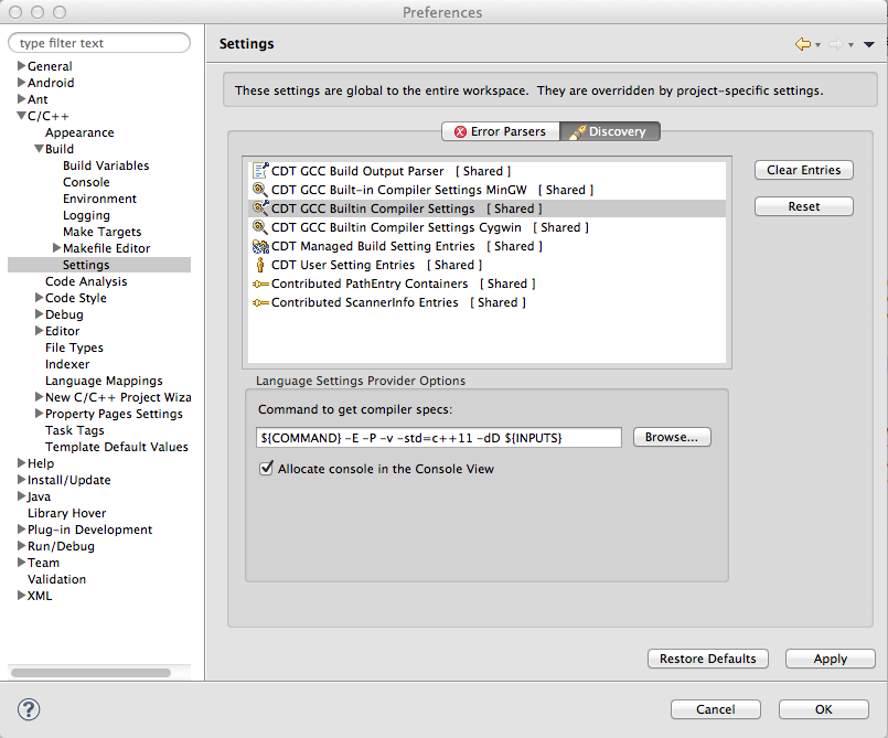

- The Discovery, Builtin compiler options include '-std=c++11'.

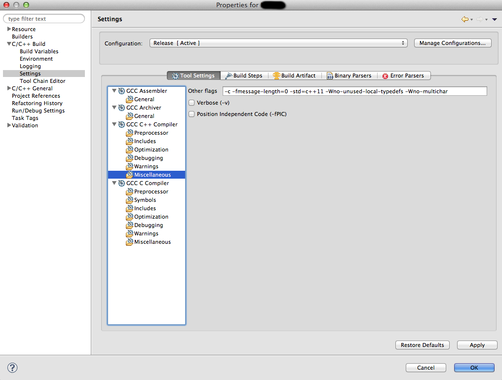

- The compiler options include '-std=c++11'.

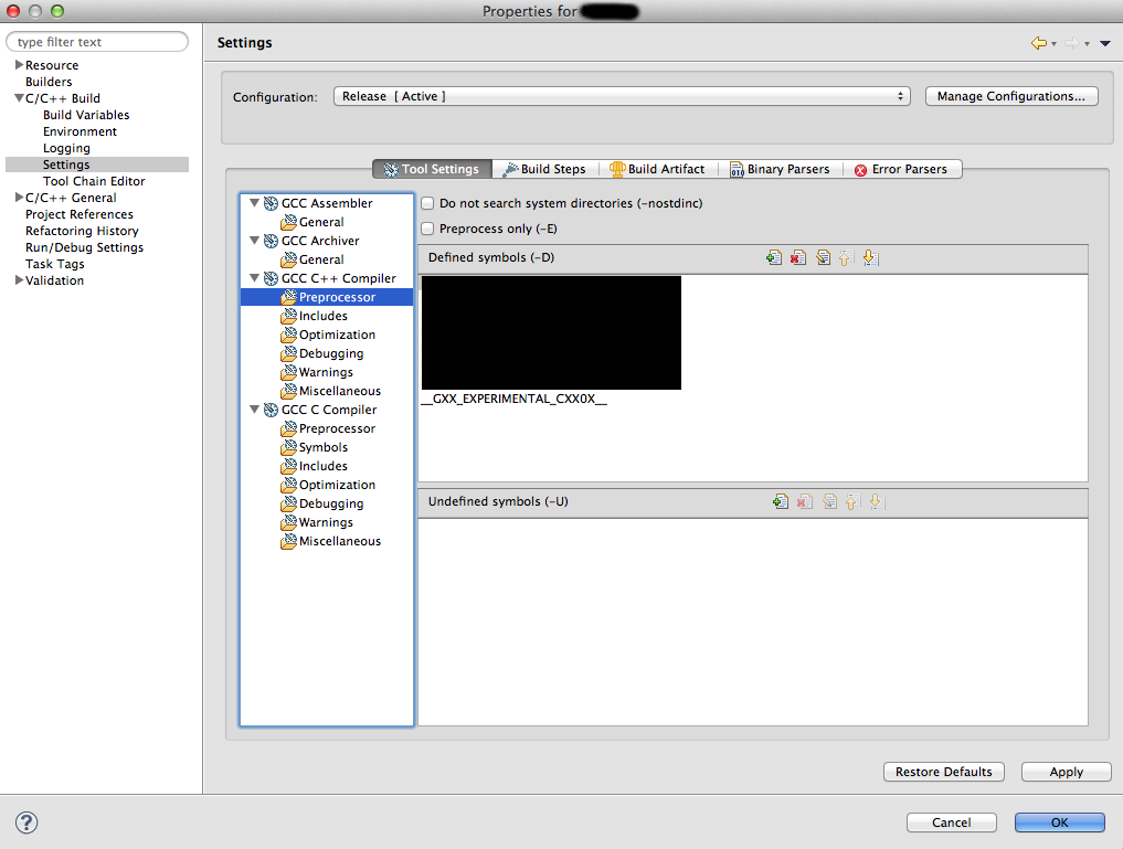

- The preprocessor macro __GXX_EXPERIMENTAL_CXX0X__ is set.

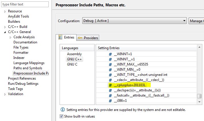

check the values under "Preprocessor Include Paths, Macros etc.". There you should find the values CDT has parsed from the scanner discovery output.
index.php/fa/15559/0/

Well, it is saying "__cplusplus=201103L" there, and also if I view the console output w.r.t. discovery options (which is probably the same thing).

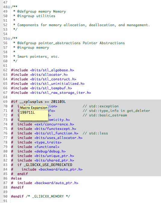

Nope. Not all solved. Suddenly, in another project, the mouse-over over the __cplusplus definition tells me that it's recognized as '1'. No idea why, and of course the indexer doesn't like that. Every setting looks ok, though, and it's telling me everywhere else (i.e. in the properties) that the macro is 201103L.
Why does this have to be such a bloody mess?

In Windows->Preferences->C/C++->Build->Settings open the "Discovery" tab
- select GCC-Builtin Compiler Settings (I think in your case it will be called GCC Mac or something linke this. I am not sure.)
- change the command line
${COMMAND} -E -P -v -dD "${INPUTS}"
to
${COMMAND} -std=c++11 -E -P -v -dD "${INPUTS}"
That's it. (Don't forget to select Mac GCC as your toolchain)
