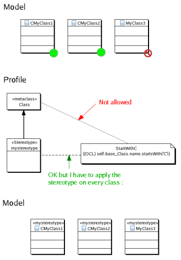

Re: OCL Constraint on all classes ? [message #1048420 is a reply to message #1047754] Wed, 24 April 2013 08:49 Go to previous messageGo to next message
I made a schema to explain the problem :)
index.php/fa/14500/0/
  • Attachment: desc.png
    (Size: 38.14KB, Downloaded 1035 times)
[Updated on: Wed, 24 April 2013 08:53] by Moderator

Re: OCL Constraint on all classes ? [message #1049190 is a reply to message #1047754] Thu, 25 April 2013 09:42 Go to previous messageGo to next message
I attached the schema in my previous message. Strange you can't see it. Here another link to the schema : https://docs.google.com/file/d/0Bxg-oe5gzYQjMkxfbEJCVWZhZnc/edit?usp=sharing
Re: OCL Constraint on all classes ? [message #1049194 is a reply to message #1049190] Thu, 25 April 2013 09:50 Go to previous messageGo to next message
From your example, it looks like you would be helped with the approach described at http://help.eclipse.org/juno/index.jsp?topic=%2Forg.eclipse.ocl.doc%2Fhelp%2FCompleteOCLTutorial.html&cp=49_3_2_8&anchor=CompleteOCLTutorial-UMLComplements, but AFAIK (Ed will probably correct me) even in Kepler, this is not yet supported in papyrus, and you would have to use the UML2 model editor on the .uml model file for the validation.

Re: OCL Constraint on all classes ? [message #1051362 is a reply to message #1049194] Sun, 28 April 2013 13:11 Go to previous message
On 25/04/2013 14:50, Klaas Gadeyne wrote:
> Hi,
> described at
Thanks. I'm glad someone reads the tutorials.
Your apparent requirement is to enhance UML not to add a stereotype, so
you need the flexibility of Complete OCL's open classes to enable you to
modify UML.
Except that if you modify UML you will need to change the spelling of
String and Integer to start with C. This can be fixed by excluding the
UML package from your style rule. Better that than introducing a
mandatory stereotype that will also have to be not applied to UML.
