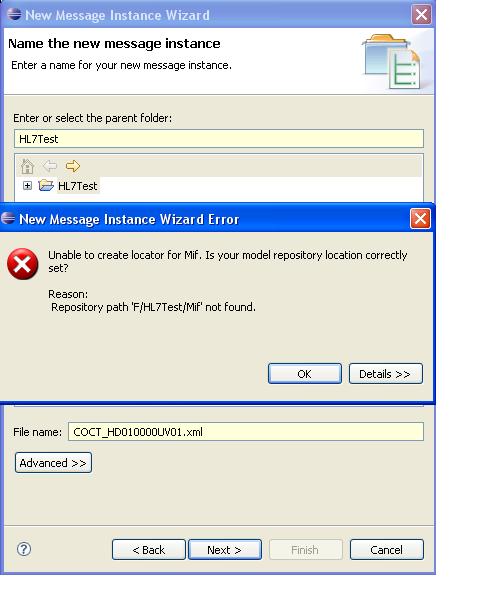

Hi guys,
when I try to create a new Message Instance I receive the error in
attachment. Any idea????
Thanks in advance.
Bye
  • Attachment: error.JPG
    (Size: 41.33KB, Downloaded 1553 times)

Originally posted by: giuseppe.italiano.agic.it
solved the problem, just a stupid case sensitive one (mif folder instead
than Mif).

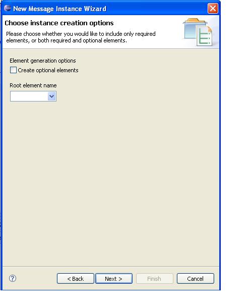

But now I have root combo empty at last step as in attachment. Why? What is
missing?
p.s: I have some problem with paths, because I had to set in
datatypes-its-xml-source.xml absolute paths for
MANIFEST.ent and vt.dtd
Any idea?

The missing root is because it can't find your mif file entry point(s).
If not, something else is amiss. If you can attached the mif file, maybe
we can help.
No ideas about the path problem though.
Regards.

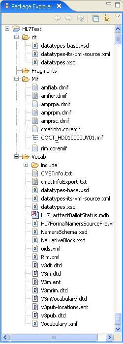

Here's my mif
But I have same problem with all mifs, so I don't think the problem is in
it.
I've attached also my project file list (probably very confused), maybe
something is wrong there
Best regards
Giuseppe

I am afraid that you're missing a critical file: cmetList.mif. However,
even with that file, you still may had problem generating the message as
the tools can't find one of: COCT_MT050000UV01, COCT_MT050000UV or
COCT_MT050000.
At the moment, the setup required for successfully generated a message
is complex, and I've been told that we would release a reference project
with everything setup so you can generate message. For further info,
please check this wikki by Brandon:
http://wiki.eclipse.org/index.php/H3ET_Project_Configuration
Dennis
>>> Any idea?
>>> "Giuseppe" <giuseppe.italiano@agic.it> ha scritto nel messaggio
>>> news:eqsabd$91b$1@utils.eclipse.org...
>>>> Hi guys,
>>>> Thanks in advance.
>>>> Bye
