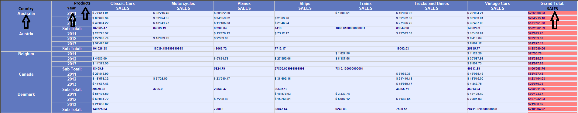

Re: Dynamic CrossTab Report Generation [message #1769598 is a reply to message #259386] Wed, 02 August 2017 02:36 Go to previous message
Hello everybody
First thanks Jason for the example. Generating a dynamic xtab is working very well!
Now I don't know how I can add the labels (please see my attached screenshot).
index.php/fa/30235/0/
Is there perhaps someone who has a example to generate a hyperlink (drill-through) to an other report (e.g. clicking on the year to reach detail Information monthly based)?
Thanks in advance.
Piero
