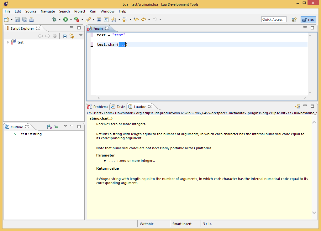

A picture of Windows 8.1 with Eclipse Lua Development Tools installed,
here the LuaDoc view show correctly formatted the contend:
index.php/fa/19464/0/

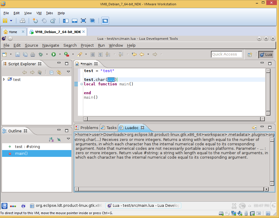

A picture of Linux Debian + KDE with Eclipse Lua Development Tools installed,
here the LuaDoc view shows only the luadoc as something like plain text:
index.php/fa/19465/0/
what I have to do to get the Linux version looks like the Windows version.
Thanks for help Smile
greetings.

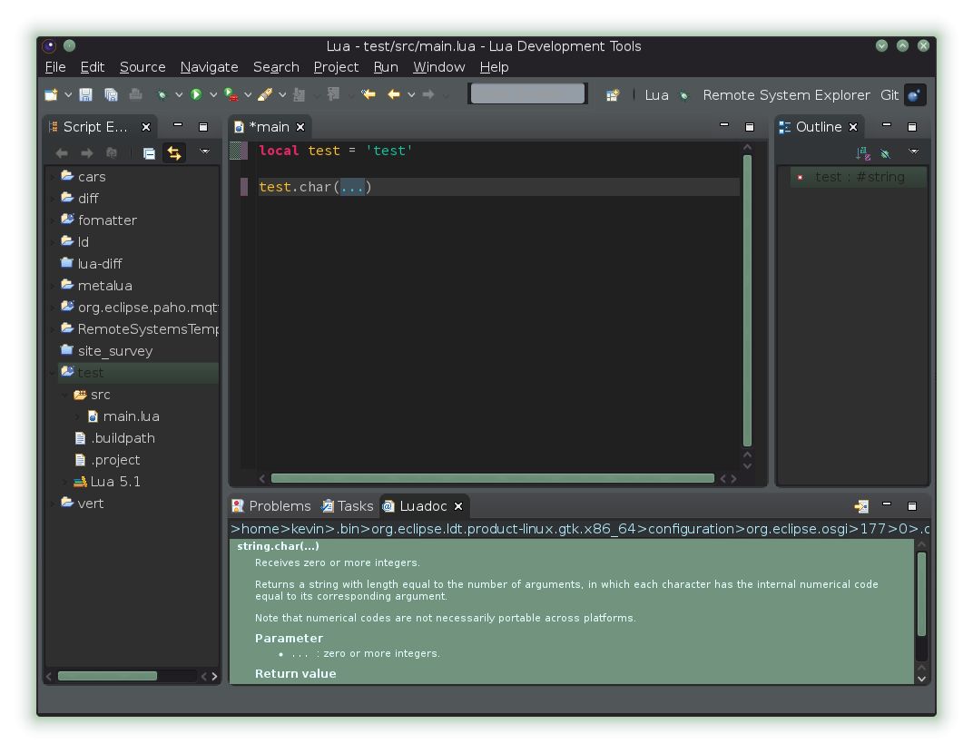

I think this is a Gtk / KDE integration issue.
Even if I am using KDE with Opensuse without issue.
index.php/fa/19466/0/
Do you have gtk2-engine-oxygen installed?
Kevin

Thanks for your reply Smile
yes gtk2-engine-oxygen is installed.
Today i made some more tests with different linux desktopts. LXDE/OpenBox and have had the same issues. (deleted the hole eclipse configuration and workspace before the tests)
Some more ideas? Smile
more information about my system:
vmware
linux debian jessy (testing)
kde/LXDE/OpenBox
openjdk 7

Ok I have tried mostly everything to get it work with my debian configuration and have had the same issues with kubuntu. The first fix for me is now to use LinuxMint KDE (no idea whats here working better). On weekend I'll look for the difference and post it here. Smile
Thanks for your help Smile
