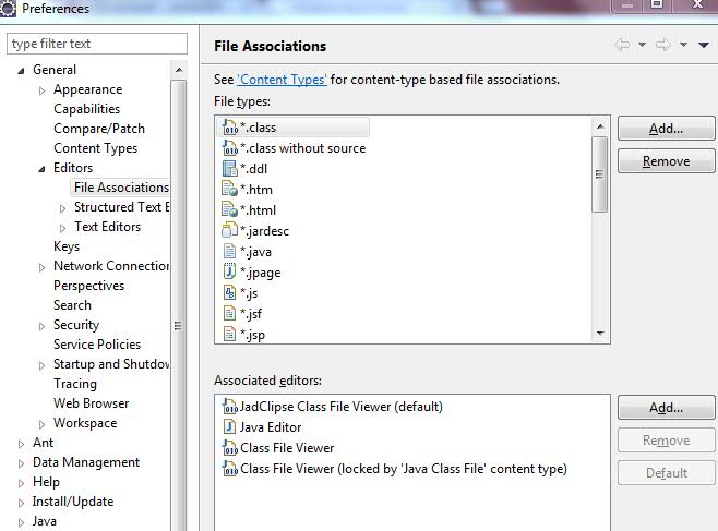

Try the below things on eclipse
window->preferences->general->Editors->FileAssociations
add the jad editor for *.class
add also check the editor for *.java. If it is not there add Java Editor for *.java
  • Attachment: eclipse1.jpg
    (Size: 49.12KB, Downloaded 1166 times)
Re: F3 navigation: how to see what libs are missing? [message #1165821 is a reply to message #257323] Fri, 01 November 2013 11:11 Go to previous message
Try the below settings in General->Editors->File Associates tab
    (Size: 49.12KB, Downloaded 2058 times)
