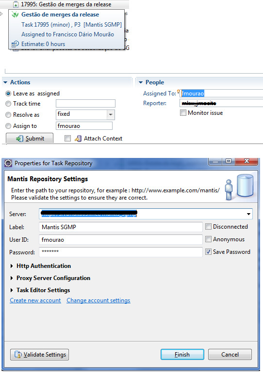

No. I don't see the gold person icon next "Assigned to <my full name>" when I hover over a task assigned to me.
The picture in attachment "mylyn-snapshots.png" shows what I see when I hover over one of my tasks, displaying my full name next to "Assigned to ". In the middle, there's a snapshot of the task detail showing that the task is assigned to my user: fmourao; and below, the mantis repository settings configured again with my user: fmourao
index.php/fa/19349/0/
I have 3 other guys from my team trying out mylyn, before spreading to the rest of the team. We all have the same environment and we are all experiencing this same problem.
Please tell me if you need more info.
Thanx in advance,
Francisco Mourão

Re: No tasks shown after selecting "Show only my tasks" filter [message #1439076 is a reply to message #1436018] Mon, 06 October 2014 17:21 Go to previous messageGo to next message
Francisco,
Thanks a lot for reporting this. I did some investigation and found out that there is a bug in Mylyn that causes this feature not to work with certain connectors. I have already started work on a fix and I hope it will be available in the next release and in a weekly build sometime soon. Weekly builds are available from the update site http://download.eclipse.org/mylyn/snapshots/weekly.
For reference, here is the Bugzilla bug I opened:
446091: [api] allow clients to determine when the current user owns an ITask
https://bugs.eclipse.org/bugs/show_bug.cgi?id=446091
Cheers,
Sam
