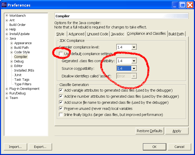

I'm trying to use RC1, but when I compile a file with an assert statement in it,
I get an error reported as:
Syntax error on token "assert", assert expected
I didn't have this problem with M8, and as far as I can tell the project
is correctly configured (in the UI anyway) as requiring 1.4 compliance and
assert usage as Warnings - not Errors.
Any one else seeing this?
Darren.
No, you need more than that.
Here is a screenshot that shows the right settings.
HTH,
Olivier

Olivier,
Thanks a million for that - never noticed the difference - didn't have to do it
in the M8 build...
