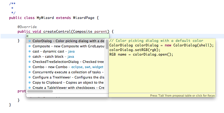

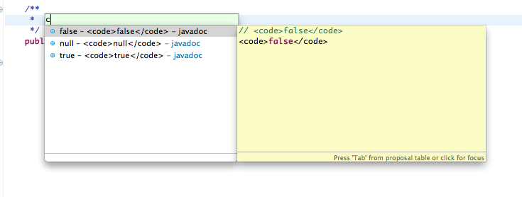

we have a big new feature coming to Snipmatch in our next release.
Snipmatch will become location aware. Snippets are bound to a specific location at which they can be found.
index.php/fa/19067/0/
index.php/fa/19068/0/
This makes the search much more comfortable as only snippets are found that make sense at the current position. Available locations are:
File - Anywhere in a Java File (this is the same behavior as before)
Java - Anywhere in Java code, not in Javadoc
Java Statements - in statement blocks, i.e. method bodies
Java Type Members - in field declaration block
Javadoc - in Javadoc
You can give the new version a spin by installing Snipmatch from our head update site: http://download.eclipse.org/recommenders/updates/head
