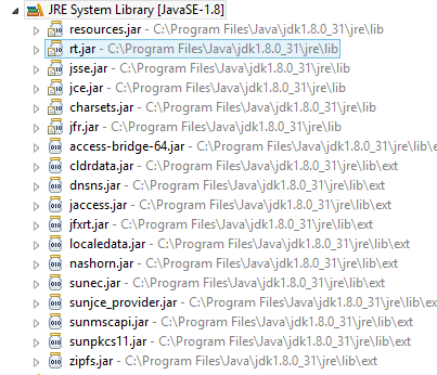

Re: jfxswt not on the classpath [message #1693798 is a reply to message #1693792] Tue, 28 April 2015 07:45 Go to previous messageGo to next message
Can you provide a screenshot of your JRE and Plugin-Classpath container
expanded.
Tom

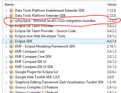

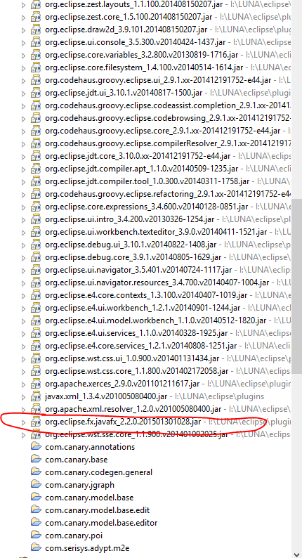

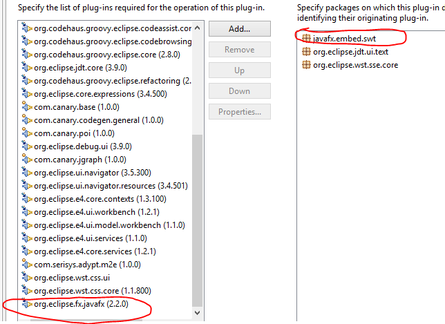

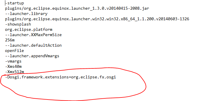

Re: jfxswt not on the classpath [message #1693898 is a reply to message #1693798] Wed, 29 April 2015 04:50 Go to previous messageGo to next message
Here is the current set up I'm trying.
I installed the minimal OSGI integration bundle from the update site (tell me if I need anything else), included the system property in the vm arguments (as specified) added the dependency and imported package in the manifest, and updated the class-path of my plug-in via PDE tools. Still can't get it to see FXCanvas. If I look in the org.eclipse.fx.javafx I can find the package, but it contains a dummy.tx and a dummy.class.
Plugin dependencies: index.php/fa/21687/0/
JRE_DEP: index.php/fa/21688/0/
Eclipse Ini: index.php/fa/21689/0/
Installed Features: index.php/fa/21690/0/
Plug-in Manifest: index.php/fa/21691/0/
Re: jfxswt not on the classpath [message #1693906 is a reply to message #1693898] Wed, 29 April 2015 05:08 Go to previous messageGo to next message
a) This feature should not have been installed to your IDE but should
have gone to your target platform or is your target platform the
running IDE?
b) your modification to the eclipse.ini is not necessary this only
modifies your host eclipse
c) You still miss the e(fx)clipse tooling who enhances the PDE
Classpath container to include jfxswt.jar hence it is not there
d) the org.eclipse.fx.javafx is only a fake bundle with no classes
because they will be loaded from the JRE at runtime with the help of
Adapter Hooks
So you have 2 choices:
a) you modify the JRE in your Eclipse install and add jfxswt.jar
=> I think you then also have to fix the accessibility rules
b) you install the complete e(fx)clipse tool suite which includes a
CSS-Editor who know JavaFX CSS properties, an FXML-Editor, ... which
you called bloat but I think you'll find out very soon are really
needed or you go back to a world where you have the HTML-Doc open
next to your IDE
if you go for a) I'm unable to help if this is not working immediately
because this is out of scope of e(fx)clipse.
Tom
