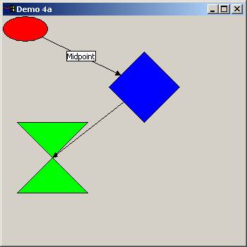

Sam,
Look at PolygonDecoration for some inspiration, that is a fastest way to
create something similar. You may also take a look at attached example
(small image + some code) for a customised versions of Polyline/Polygone.
Rotations are rather primitive and if you need to rotate/move/scale complex
figures you will need to write your own version of Transform (at least I
have such feeling). Using current implementation keep in mind that your
center of rotation always have (0,0) coordinate and define you figures
accordingly.

Re: Create a Diamond Class using Polygon Class in GEF [message #24485 is a reply to message #24400] Sun, 06 October 2002 17:41 Go to previous messageGo to next message
Originally posted by: sy_cheung2.yahoo.com
Alex,
Thanks for your help.
I notice you have 2 class PolylineEx and PolygonEx.
What are the difference between these 2 classes and the Polyline and Polygon
in org.eclipse.draw2d.
Thanks. again.

Re: Create a Diamond Class using Polygon Class in GEF [message #24525 is a reply to message #24485] Sun, 06 October 2002 18:49 Go to previous messageGo to next message
setBounds, setScale, setRotation

Re: Create a Diamond Class using Polygon Class in GEF [message #24725 is a reply to message #24525] Sun, 06 October 2002 21:12 Go to previous messageGo to next message
Originally posted by: hudsonr.us.eye-bee-em.com
"Alex Selkov" <as@empproject.com> wrote in message
news:anqdbb$rkb$1@rogue.oti.com...
The original draw2d versions are different. The intended usage there is
that you set the POINTS, and the bounds of the figure are a side-effect of
setting the points.
I haven't looked at Alex's implementation yet, But I'm guessing that in his
implementation, you provide a PointList relative to 0,0, and that PointList
is stretched and translated until it fills the bounds of the figure. We'd
like to provide this in draw2d as well. Any suggestions on distinguishing
the two names?
> > news:anq8a8$ptt$1@rogue.oti.com...
> > > Sam,
to
> Polyline/Polygone.
> > complex
least
> I
your
> > > accordingly.
> > > Regards,
> > > as

You are right, I simply use your Decoration as a prototype. My Polyline is
compatible with draw2d version because I use inverse trasfomation in
addPoint/setPoint. All of my code looks ugly and cry for refactoring because
a lot of functionality can be pulled up. For example two identical versions
of Polygone distingushed only by the name of superclass. PolygonDecorations
and PolylineDecorations can be trivial classes. Currently it's difficult to
suggest a good name prior to refactoring... A small number of interfaces may
be also a useful addition (Rotatable, Scalable etc)
And notifications also looks complicated from a user perspective:
firePropertyChange in Polyline to support connections looks unnatural for
generic Polyline figure, fireMoved must be fired when I change
shape/orientation to support attached connections correctly... I think that
your future article about complex figures must touch this issue.
