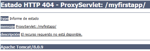

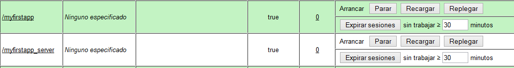

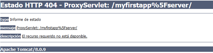

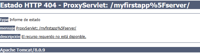

Re: HTTP 404 [message #1394987 is a reply to message #1394877] Sun, 06 July 2014 02:41 Go to previous messageGo to next message
thanks to you by your help.
I read everything and i didn't see anything different.
I made my scout test application, then I exported like a project
http://localhost:8080/myfirstapp
http://localhost:8080/myfirstapp_server/
see Image 1 app deploy
see image 2 Error
May be my problem it's inside the environment variable. But i'm not sure about it.

Re: HTTP 404 [message #1395176 is a reply to message #1395076] Sun, 06 July 2014 09:59 Go to previous messageGo to next message
first of all, my apologies to this forum by the white comment before, it was the browser fault Very Happy.
[b][Bahtiyor Ruzimatov][/b] I appreciate your response, and your advise too.
//i changed the port in scout aplication just like you said.
When I tested in scout, all it is fine, the rap package, and the swing UI.
Then I exported my project and I let the default values.
Start tomcat, and It made the deploy, but unfortunately, i've gotten the same error.
would you mind show me xml file that is working.
see my image 4-5

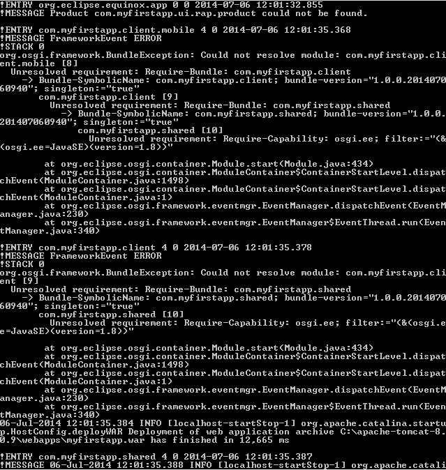

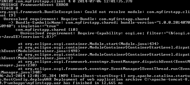

Re: HTTP 404 [message #1395348 is a reply to message #1395243] Sun, 06 July 2014 16:14 Go to previous messageGo to next message
[Bahtiyor Ruzimatov] I feel glad by your response.
I am doing everything to make a well deploy.
But just now, I've notice that Tomcat isn't correctly running my app.
When I start Tomcat 7 or 8, it show up a several error, when it is trying to make a right deploy.
Those error never appear in eclipse, but TOMCAT said ( Image 1 and Image 2).
Now i am thinking that my problem is inside my own project.
Would you mind check this error?
  • Attachment: problem.PNG
    (Size: 41.90KB, Downloaded 542 times)
  • Attachment: problem2.PNG
    (Size: 18.62KB, Downloaded 625 times)
Re: HTTP 404 [message #1395637 is a reply to message #1395348] Mon, 07 July 2014 03:10 Go to previous messageGo to next message
It seems to me that you have a Java Version problem.
Are you sure you run tomcat with the java version you prepare your application for?
What is the version indicated as required in the MANIFEST.MF files of your application. I have:
Bundle-RequiredExecutionEnvironment: JavaSE-1.7
How are you building your application?

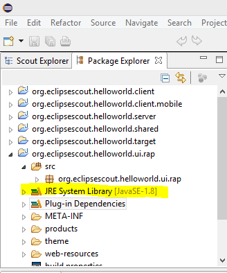

Re: HTTP 404 [message #1395789 is a reply to message #1395637] Mon, 07 July 2014 07:59 Go to previous messageGo to next message
Thanks by your response.
I can see that inside the manifest file, its require J2SE-1.4
How can I change this in the eclipse scout app?
But look at my JDK, it say JDK 1.7.
And now that we're talking about the java version, what does mean "java Library 1.8"
if I have running java 1.7 in my laptop pc? [see image]

Re: HTTP 404 [message #1395795 is a reply to message #1395789] Mon, 07 July 2014 08:08 Go to previous messageGo to next message
It looks to me that this is the content of "org.eclipse.equinox.servletbridge/META-INF/MANIFEST.MF"
Your application is constituted of multiple bundles.
Switch to the "Package Explorer" View. Have a look at the Manifest files:
* com.myfirstapp.client/META-INF/MANIFEST.MF
* com.myfirstapp.shared/META-INF/MANIFEST.MF
* com.myfirstapp.server/META-INF/MANIFEST.MF
Re: HTTP 404 [message #1396037 is a reply to message #1395795] Mon, 07 July 2014 15:55 Go to previous messageGo to next message
Now its working!!!!!!!!!!!!!!!
yupiiii
now how can I close or mark this thread as done?
Very Happy
What was the answer Evil or Very Mad jejejje
I am not going to let you down.
I made a video with the solution, but I am glad to say that the problem
was the java configuration.
I reset everything from scratch
See this video if you want more details.
http://youtu.be/UykJIA5TQXA
