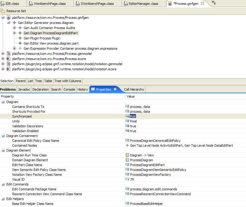

I set diagram synchronized in gmfgen and generated the diagram, according to
http://help.eclipse.org/help31/index.jsp?topic=/org.eclipse. gmf.doc/tutorials/diagram/canonicalContainer.html,
then I change the extension "contributionItemProviders" in the plugin.xml to
make the "deleteFromDiagramAction" visualable in popup menu .

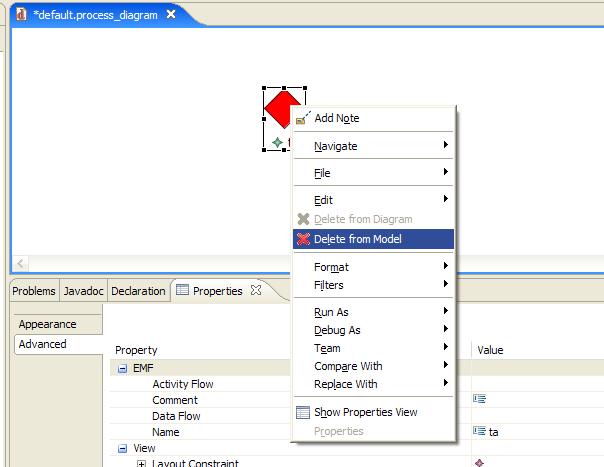

but the Action "deleteFromDiagramAction" is disabled in popup menu, because
of the ProcessDiagramCanonicalEditPolicy(), if I delete the
ProcessDiagramCanonicalEditPolicy(), then the Action
"deleteFromDiagramAction" is abled.
so If I install ProcessDiagramCanonicalEditPolicy() to make diagram
synchronized, then the "deleteFromDiagramAction" will be disabled. If I want
to make diagram synchronized, and the "deleteFromDiagramAction" enabled,
what should I do?

Hi ;
The canonical behavior means the View will exist only if the semantic
element (model element) exist, and the view will be deleted as soon as
the semantic element is gone.
Based on this there is no point in enabling delete from diagram on the
canonical views because of 2 reasons:
1- if you delete the view only then the canonical edit policy will
recreate another similar view to represent semantic element.
2- delete from model will result in deleting both the semantic and the
view elements

finally ,I add a menu by myself with the "delete from diagram" function .
If you debug through the code, you will find that in the gmf runtime code it
will jude whether you have installed connonical editpolicy, if you do, it
will disable the "delete from diagram" function by returning null commond.
