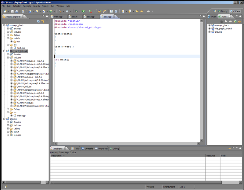

Here is a screenshot of what I'm talking about:
http://i42.photobucket.com/albums/e306/nroberts-photos/grrr. png?t=1214251039
Notice the duplicates of the c:/mingw directories in addition to the
/mingw copies of the same. That makes 3 entries for each individual
directory that actually exists.

Actually I think my problem is one of design. I'm not allowed to edit
these values when they are wrong. If eclipse would just let me tell it,
"No, don't do that!" then things would be great.
I can work around it, I think, by putting mingw in a place that is not
c:\mingw. Then mingw doesn't return the /mingw paths as includes and so
eclipse doesn't pick them up. The problem is that when I do this, and I
set the PATH variable correctly, eclipse can't seem to give me access to
the MinGW toolchain. It seems to think that mingw doesn't exist.
These /mingw directories make totally sense also on a Win32, since this
is the path used in the MSYS shell used (which is also used for building
MinGW and the reason for this paths).
Re: includes hosed [message #217792 is a reply to message #217777] Tue, 24 June 2008 18:30 Go to previous message
Originally posted by: noah.roberts.eng-software.com
Yes, I realize that. But that is the only thing on a win32 system for
which it does make sense. Any program that doesn't pretend it's on a
unix system, is not run from msys, and is run from another drive will
have a really hard time understanding it. Eclipse appears to fall into
the category of not being able to make sense of it.
Quite simply, it's not a standard path specifier on the win32 system and
should be ignored by eclipse. Further, eclipse should certainly allow
one to delete such nonsense paths in the includes.
