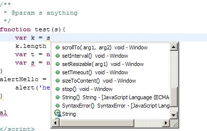

Re: JSDT - jsDoc not used for code completion? [message #216408 is a reply to message #216368] Mon, 30 June 2008 14:14 Go to previous messageGo to next message
content completion works for me on the string type-- see attached
screenshot. could you give an example/recreate for the other problem you
mentioned?
-brad

Here is my screen shot (I'm so glad I finally learned how to make
these):<br>
<br>
<img alt="screen shot" src="cid:part1.06060605.08060802@resnbl.com"
height="345" width="421"><br>
<br>
Items I noticed about your screen shot:<br>
<br>
1) Window object definitions: you're obviously running with more than
the default ECMA-262 library, I am not.<br>
<br>
2) You list includes the String object itself, but I don't see the
"split" or "slice" methods that should be visible in your list (String
properties/methods are what I'm looking for).&nbsp; Even when I do get
code-completion (with, for example, " var x =
'abc'; x. "), there is no "String" class object with the green (C)^
icon in my proposal list.<br>
<br>
3) Why would you expect String proposals if you typed the parameter as
"anything"?&nbsp; Do *all* defined types in any source file or "libraried"
file show up in the list?&nbsp; That wouldn't seem helpful.<br>
<br>
I'll work up an example for the other item and append it to this thread
later...<br>

Re: JSDT - jsDoc not used for code completion? [message #216840 is a reply to message #216408] Sat, 05 July 2008 06:24 Go to previous messageGo to next message
This is a multi-part message in MIME format.
--------------010006020307050703030002
Content-Type: text/plain; charset=ISO-8859-1; format=flowed
Content-Transfer-Encoding: 7bit
Bradley -- after some further testing, I think I've determined the
difference between your output and mine: you didn't type a period (".")
after the "var k = s"! If fact, in your test, if you were to select the
"String" entry from the list, the word "String" will be substituted in
place of the "s", which is not the intended effect at all. I'm
expecting the list of String properties and methods, not the String
class itself.
Can you re-test by typing a "." after the "s", and hitting Ctrl-Space to
induce code-completion?
Bob Shields

<blockquote cite="mid:g4b7n1$h6v$1@build.eclipse.org" type="cite">
<pre wrap="">content completion works for me on the string type-- see attached
mentioned?
-brad

Re: JSDT - jsDoc not used for code completion? [message #217128 is a reply to message #216840] Tue, 08 July 2008 16:41 Go to previous messageGo to next message

Hi Bob,
I think I understanding your issue a bit better now. The problem is =
that even though function parameter 's' is listed as type "String" in =
the JsDoc, the inference engine isn't marking it as String for content =
completion within the function (it's of type 'any') . I was under the =
impression you weren't finding the type "String" when using code =
completion.
This isn't necessarily a bug since it requires some inferencing that s =
is String from JsDoc and not of type 'Any'. But I would consider it an =
uncomfortable missing feature. Please open a bug report and we can see =
about doing function parameter inferencing from JsDoc in the very near =
future.
-Brad

Bradley -- after some further testing, I think I've determined the =
difference between your output and mine: you didn't type a period (".") =
after the "var k =3D s"! If fact, in your test, if you were to select =
the "String" entry from the list, the word "String" will be substituted =
in place of the "s", which is not the intended effect at all. I'm =
expecting the list of String properties and methods, not the String =
class itself.
Can you re-test by typing a "." after the "s", and hitting Ctrl-Space =
to induce code-completion?
Bob Shields
Bradley Childs wrote:=20
content completion works for me on the string type-- see attached=20
screenshot. could you give an example/recreate for the other problem =
you=20
mentioned?
-brad

understand why there would be no suggestions, but the jsDoc is present!
This is actually a simplified version of a larger issue: I have
attempted to generate a number of code-completion libraries for my
external Objects, and they work fine within the scope of the function
that obtains an instance of the Object. But if I then pass that Object
to another function, I lose code-completion even though the jsDoc
correctly defines the type of the Object for that function parameter.
On a side note, is this the best place for JSDT discussions? I would
think that with the number of (duplicated) news items about JSDT in this
release, there would be a lot more active discussion...?
Bob=20
<blockquote cite="mid:g50j9m$v4t$1@build.eclipse.org" type="cite">
<title></title>
<meta http-equiv="Content-Type" content="text/html;charset=ISO-8859-1">
<meta content="MSHTML 6.00.2900.3059" name="GENERATOR">
<style></style>
<div><font face="Arial" size="2">Hi Bob,</font></div>
<div>&nbsp;</div>
<div><font face="Arial" size="2">I think I understanding your issue a
bit better now.&nbsp; The problem is that even though function parameter 's'
is listed as type "String" in the JsDoc, the inference engine isn't
marking it as String for&nbsp;content completion within the function&nbsp;(it's
of&nbsp;type 'any')&nbsp;.&nbsp; I was under the impression you weren't finding the
type "String" when using code completion.</font></div>
<div>&nbsp;</div>
<div>&nbsp;</div>
<div><font face="Arial" size="2">This isn't necessarily a bug since
it requires some inferencing that s is String from JsDoc and not of
type 'Any'.&nbsp; But I would consider it an uncomfortable missing feature.&nbsp;
Please open a bug report and we can see about doing function parameter
inferencing from JsDoc in the very near future.</font></div>
