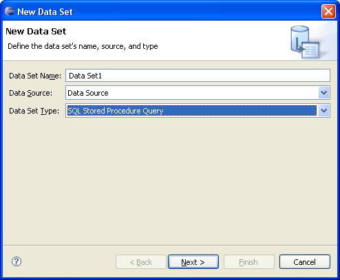

when i wish to add a new data set, i right click then select the "new data
set", at data set type, i select the "sql stored procedure query", then i
will get "{call procedure-name(arg1,arg2, ...)} "
