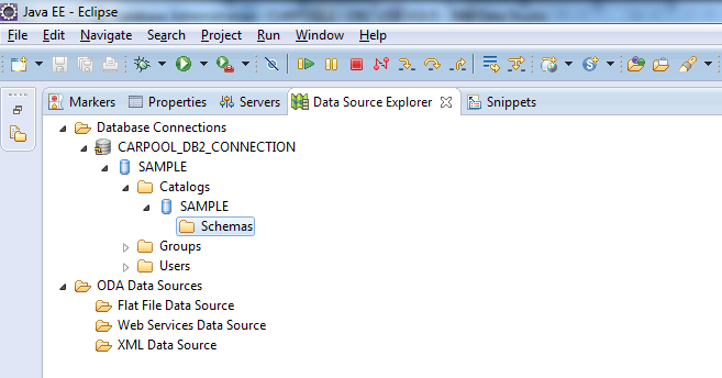

Data Source Explorer does not show tables in the database schema even though it connected to the database. It connects correctly with the DB2 Database but unfortunately, the tables are not displayed under the schema

Hi, this problem has been fixed in DTP 1.11.2. (Kepler SR2)
The DTP IBM "enablement" plugins (org.eclipse.datatools.enablement.ibm.xxx) have been reworked to include a catalog loader that is specific to DB2 for LUW. Previously it was using the default (Derby) catalog loader, which does not work for DB2 releases after v9.5.
