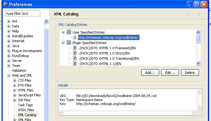

Originally posted by: valentinbaciu.hotmail.com
Steve, here's a suggested workaround.
The broken MIME schema is contributed to the XML catalog by the org.wsdl4j
plug-in. You should be able to override it by specifying a user catalog
entry pointing to the new schema. So download the new schema from the URL I
mentioned below then go to Preferences/Web and XML/XML Catalog, select the
User Specified Entries and click Add. In the dialog browse to the location
where you placed the downloaded schema, specify namespace name as the key
and enter the proper namespace in the namespace field. Click OK and save the
preferences and you should be all set. Try re-validating your file: the
error should go away. I've attached a picture showing the end result of
adding the new schema to the catalog.
Valentin

>> <soap:binding transport="http://schemas.xmlsoap.org/soap/http"
>> style="document"/>
>> <operation name="compose">
>> <soap:operation soapAction="urn:beta-service"/>
>> <input>
>> <soap:body use="literal"/>
>> </input>
>> <output>
>> <mime:multipartRelated>
>> <mime:part name="headers">
>> </mime:part>
>> <mime:part name="preview">
>> <mime:content part="Content" type="text/binary"/>
>> </mime:part>
>> </mime:multipartRelated>
>> </output>
>> </operation>
>> </binding>
>> <service name="EngineService">
>> <port name="EngineServicePort" binding="exst:PreviewReportBinding">
>> <soap:address
>> location="http://localhost:9080/beta/services/EngineService"/>
>> </port>
>> </service>
>> </definitions>
  • Attachment: pic.JPG
