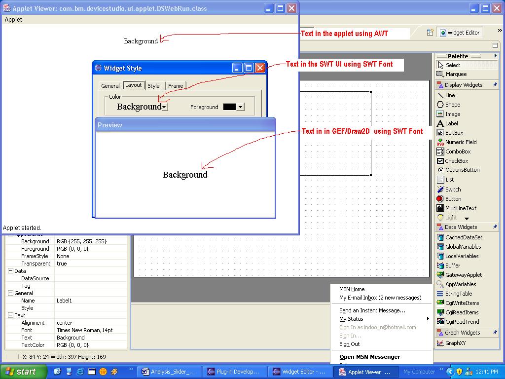

We are facing a problem related to Font. When we use a Font for a
particular control (say Label ) at design time it shows a size which is
different from the size shown in applet . i.e Same Font in SWT and AWT
show different size ( even we set same size and other properties in both
case ). Can anybody help us in fixing this problem.

When we applied same Font ( Times New Roman ,14 ,Normal) we got the
different results in pure SWT and GEF/Draw2D and Applet . Please find the
attachment .I have marked the three results .
thank you for your valuable time
Shaiju.P

The Java(tm)2D API adopts the convention that one point is equivalent to
one unit in user coordinates. When using a normalized transform for
converting user space coordinates to device space coordinates 72 user
space units equal 1 inch in device space. In this case one point is 1/72
of an inch.
For Windows system, the default is 96 dpi, So in most swing application,
the font in size 12 is the same as the 9 in system...
"Shaiju" <shaiju@exorindia.com> д
