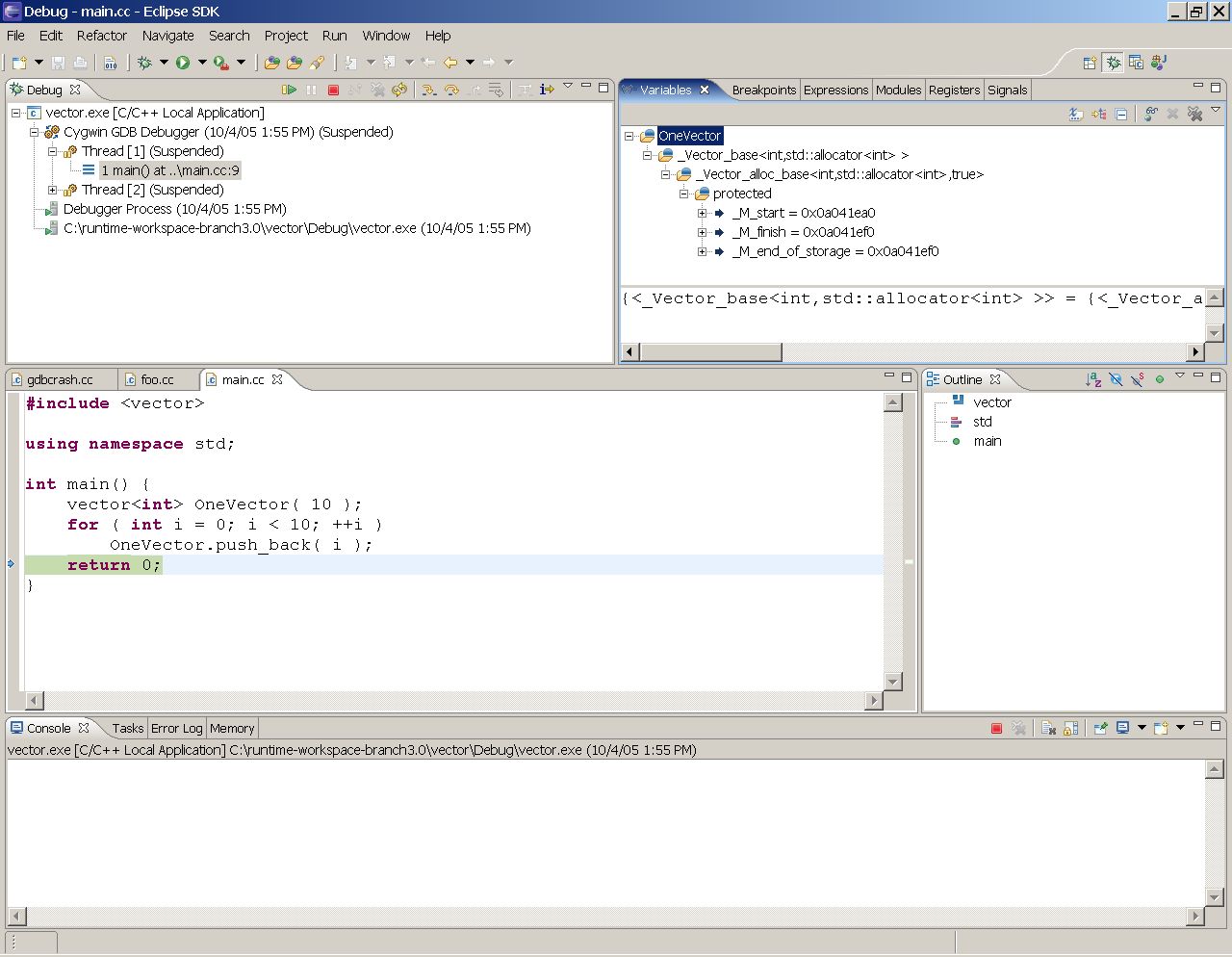

Re: How to debug a vector [message #155695 is a reply to message #155653] Tue, 04 October 2005 14:01 Go to previous message
Originally posted by: mikhailk.qnx.com
I see a similar output in the Detail pane of the Variables view, but the
tree looks fine.
