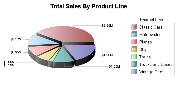

I played around with the pie chart and was not able to figure
out if it is possible to rotate the chart along the x,y and z
axis. One the one hand I would like to start with the biggest
slice at 12 o'clock, then I would like to bend it back a little
so that the pie is show more from the side and finally I would
like to influence the transparency of the pie itself.
Is this possible?
Nima
Re: How to rotate the pie chart? [message #153898 is a reply to message #153731] Mon, 17 April 2006 14:58 Go to previous messageGo to next message
You can sort the category data on the chart to have the biggest slice at the
top . You can't really rotate along x, y,z axis, but you can modify the pie
ratio to simulate a 3D perspective together with the 2D with depth setting.
You can set the transparency with the translucent setting.
Here is an example, although the transparency cannot be seen through
gradients (but if you don't use gradients for the palette, it will be
translucent).
David

Hi David,
looks nice. Thanks for the reply.
